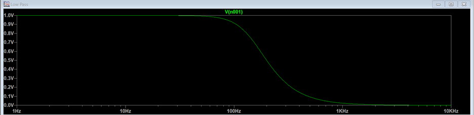

Step 3: Building Low Pass Filter
To create the low pass filter with a cutoff frequency of 150 Hz, obtain a breadboard, several wires, one uA741 op-amp, one 18 kOhms resistor, one 18 kOhms resistor, one 0.033 uF capacitor, and one .068 uF capacitor. Connect these components using the schematic shown above.
Connect a battery supply to the breadboard to power the op-amp and send a 10mV sin wave through the circuit. Display the output signal on an oscilloscope. This circuit can be verified by varying the frequency of the sin wave and noticing a drop in amplitude at 150 Hz and above.
