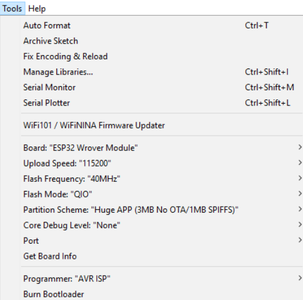

open files menu in arduino IDE. and then open preference and paste the link in additional boards managers URL and press OK:
https://raw.githubusercontent.com/espressif/arduin...
after that install the ESP32 library from include library menu.
open the tools menu and make changes to parameters according to shown above in images.
In the code give name of the access point to be connected and SSID of that access point
Once done this connect the USB to TTL module to your PC and upload the the code given below. After successfully uploading the code open the serial monitor. after connecting to Wi-Fi the ESP32 will show local IP address. NOTE THAT DOWN.

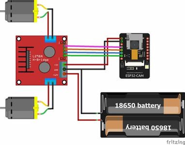

Step 4: Wiring and Powering Up the Main Circuit
after uploading code disconnect USB to TTL Module completely from ESP32-CAM and connect jumper wires to L298N module as shown in diagram :
Now for powering the car we will use 12v Li-ion battery, connect accordingly
+Ve of battery to ---- +12 of L298N
-Ve of battery to ----- GND of L298N
For powering up the ESP32-CAM module we will use L298N's +5v as source to do this Place the power jumper which is left on board.
connect :
L298N
+5 -------- 5v of ESP-32 CAM
GND -------- GND of ESP-32 CAM
IN1 --------- GPIO 14 of ESP-32 CAM
IN2 ---------- GPIO15 of ESP-32 CAM
IN3 ---------- GPIO13 of ESP-32 CAM
IN4 ----------- GPIO12 of ESP-32 CAM
since we are not going to control the speed of car and will run at max speed place the ENA and ENB jumpers in place.
