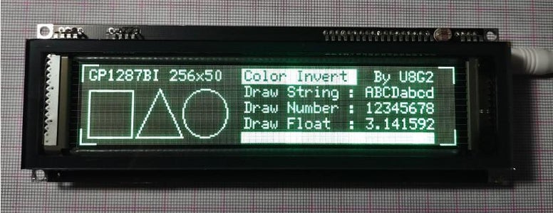

First I will test the device with a short demo sketch that is an integral part of the library, which demonstrates some of the graphical capabilities
In the code, we only need to enter the credentials of the local Wi-Fi network, and then upload it to the microcontroller. As for this procedure, this time we will not hold back, because it has been described several times in my previous projects, and there are also excellent tutorials on the Internet.
After turning on the device, we need to wait for a certain time while the microcontroller connects to the Wi-Fi network and NTP servers. As seen on the screen, the correct time appears with the largest digits, the date is displayed below it, in the upper right part of the screen there is numerical information about the day of the week, and below it the day of the week.
