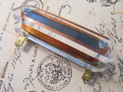

Step 3: Begin Building Your Bobbin!
First I took the magnets and taped them together. I took a piece of postal tape and stuck it to my table with the sticky side up (with the ends folded underneath and stuck to the table). I then took the magnets in stacks of two and stuck them on the tape end to end. Make sure that the magnets all have their poles facing the same direction. For me that meant having a compass to check polarity, placing the magnets so that their north poles were down and south poles were up. Which pole is up or down doesn’t matter. The magnets will fight you, and generally try to stress you out, but stick them to the tape and then fold the tape up onto their sides. For appearances I didn’t wrap the tape over the top, just the bottom and sides. Trim excess tape with scissors.
Step 4: Cut Out Plastic
Next, I cut out my plastic. Go slow and be very precise on the next few steps. If you feel yourself getting impatient then either take a break and/or fill a bucket with cold water and stick your head in it! Otherwise you are well on your way to creating a crumby pickup, which is very discouraging.
My plastic was already the right width, 7/8”, so I put it in my vise between two pieces of cardboard and cut it with a hacksaw. The length you are going for is 3 1/4”, so cut it a little long and then take it out and grind it to the precise length with a bench grinder. Also, grind the corners at a forty-five degree angle until you have turned the corners into sides that are 1/4” long.
Step 5: Drill! (Carefully)

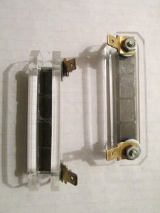

Drill the holes for the bolts with a 9/64ths drill bit so that they are 6.4cm apart from center to center. Make sure they are otherwise centered on your piece. I drilled the holes in another piece of plastic first, then once I knew I had it right I used it as a template to mark the piece I was going to use. Then I drilled it, stacked it with the second piece and ran the drill through the first piece and the second. This will ensure that your holes line up properly and your bolts will slide through. Wrap cellophane tape around the bolts and stick the ends to the sides of the magnets. Now your pickups are ready to be wrapped with wire, which is the next step.
Step 6: Almost Ready to Wrap...
One difficulty is the transition from the tiny wires of the pickup’s coil to larger hookup wires. The best way I found is to make some sort of post on the pickup itself that both can be soldered to. I found some brass pieces from a microwave that slide connectors attach to. Holding them in my vise I drilled holes in them, cut them in half, and bolted them on the bottom of my pickup.
Next, I assembled the pickup. Look at the pictures to help you.

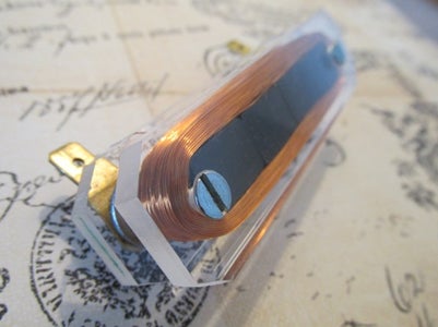

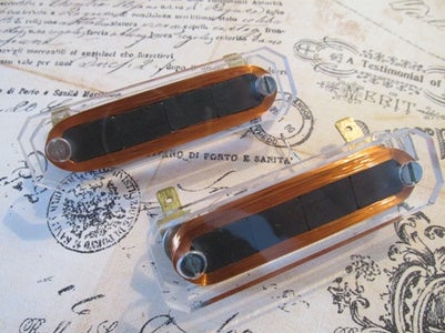

Step 7: Winding!
Next, wind the pickup. You have a choice between winding your pickup completely by hand or using a motor to assist you. I tried various things, but came back to something I cranked by hand. If you have a sewing machine with a flywheel, I suggest you use that. The only difficulty is in attaching the pickup to the flywheel. The best solution for me was to stick magnets to the flywheel, then tape a cardboard jig to the flywheel over that. The magnets hold the pickup to the flywheel, the cardboard jig keeps it from sliding. You can see the crumby jig I made in the picture. I used clear cellophane tape to control the wire at the beginning and the ends of the wire. I'm sorry that this part of the instructable is a little skimpy, refer to other intstructables or how tos for more details.
Step 8: Solder, and Your Pickups Are DONE!
Solder the ends of the wire to the brass (see picture). I found that burning the insulation off the wire with a candle flame to work well. I also used a little flux, but it isn't necessary.
Okay, now you are ready to put your pickups to work. I hope to add to this instructable when I get the next step, which is filtering and boosting the signal with op-amps, soon.
