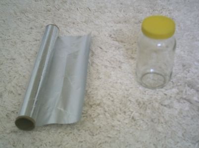

Step 1: Materials
You will need only a glass jar with plastic cap and Aluminum foil roll.

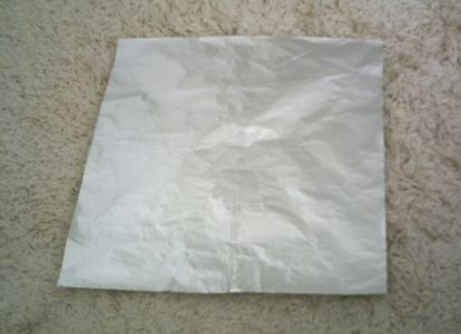

Step 2: Making an Aluminum Ball
Cut a square 10 x 10 of Aluminum foil and smash it in something resembling a ball

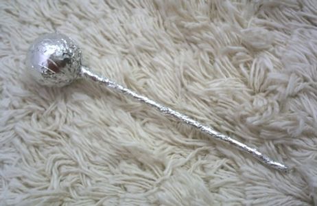

Step 4: Ball and Rod
The rod and the ball made with smashed Aluminum foil.
Step 5: Connecting Rod and Ball
Connect the ball with the rod wrapping a piece of Aluminum foil covering the ball and twisting the end over the rod.

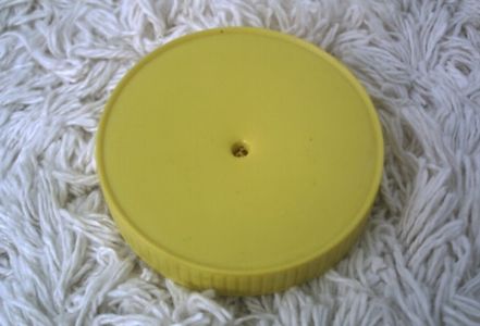

Step 6: Drilling Plastic Cap
Take the plastic cap and make a centralized hole on it enough to the rod pass through, use a puncher or an electric drill.

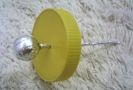

Step 7: Mounting
Introduce the rod in the cap leaving the ball outside when the jar is covered.

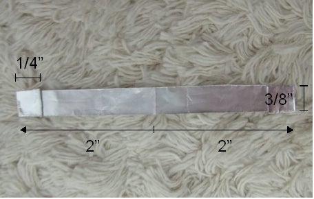

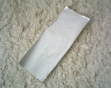

Step 9: Preparing the Aluminum Leaf
Take a 10 strip of Aluminum foil and fold the extremities leaving it with the dimensions given in the figure.

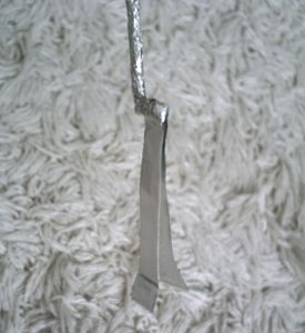

Step 10: Mounting the Internal Structure
Connect the folded foil with the rod/ball conjunct by curving the bended end over the middle of it.
