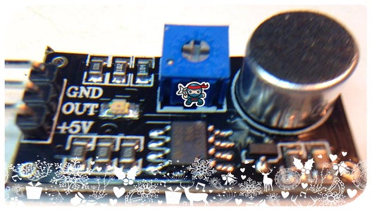

The FC-04 sound sensor module, in my opinion, is a very sensitive sound detection module for the price. Although this sensor does not provide any ability to identify specific sounds or the frequency of a sound it does do what it is supposed to - it detects sound.
The key to this sensor is the on-board potentiometer (POT) which is referenced in pic 2 above as the "sound set point adjust". Every reference I saw said that POT was for adjusting the "sensitivity". Well, naturally I assumed the "sensitivity" being adjusted was the microphone pickup, as in a GAIN control. Nope, just to mess with my head, that POT adjusts the "sensitivity" of the voltage trigger point (VTP). Meaning that it adjusts the level of voltage (internally on the pickup) required to trigger OUTPUT.
To successfully use this sensor you need to adjust that POT until you find the sweet spot for the VTP that works best with your project, in your environment. Do note that turning the POT a tiny,tiny,tiny bit to far in either direction will leave the output stuck on HIGH or LOW (not forever, just till you turn the POT back).

Adjustable Sensitivity - via on-board POT (potentiometer) - This adjusts the OUTPUT voltage trigger point (how much sound is required before the sensor triggers the OUTPUT pin. Adjusting this POT to high will cause the OUTPUT to remain HIGH, to low and OUTPUT will remain LOW. Finding the "sweet spot" where the module responds as desired can be tricky.
Pins on Module - three (3), VCC / GND / OUTisOn-Board LEDs - Red LED, power indicator Green LED, on when sound is detected
