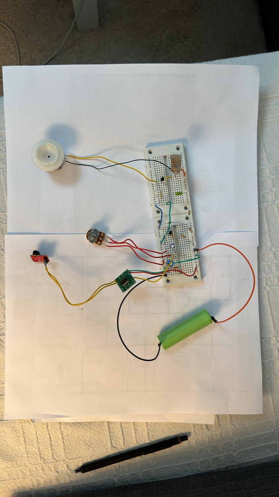

Step 5: Loudspeaker Version Without Germanium Diode
in this circuit first transistor must be 2N3904. Other general purpose NPN transistors wont work.
Also Antenna size is critical. Long antenna (or even antenna) can block tank circuit. You can find correct frequency range by varying coil turns and antenna size.
Radio circuits need some patience and lots of try to find your optimum circuit.
L1 Coil Winding counts also depends your Variable Capacitor. C1 is good between 20pf-170 pf.
Mini plastic Capacitors will be good for our purpose.
Zener circuit added for voltage stability. Otherwise frequency goes down when battery downs.
PAM8403 is a useful 5V Ampfi module but it can work good with 1S(3.7V) Li-ion battery.

After getting work that circuit, its recommended to make soldered version. Its much more stabile. HF devices not properly working on Breadboards.
