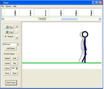

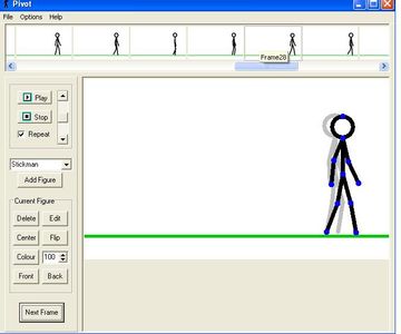

To make Your own walking animation:
Open up Pivot.
Since the stickman is already there, simply click next frame. and move the stickman to any position.
First thing you'll see is a gray figure behind the stickman. This is a very neat and probably the most important feature in Pivot that shows the position of the figure in the previous frame. Its very useful if you forget what hes supposed to do now.
In this step I'm gonna cover the most fundamental and probably most asked question of Pivot animation : Walking
Try this:
  • Observe each ilustration.
  • Make each illustration in 2 frames. That is, draw each picture and click next frame 3 times before making the other picture.
  • When you're done click play
  • You just made a walking animation!

  • Frames 1-4 are the energy ball. This is used to show where it comes from. (Remember to add the color in this first part, or else the whole thing is basically ruined!)
  • In frames 5-6, I moved the ball closer to the center. Remember to think up the path the ball will follow before you start the animation.
  • In frame 7, the ball is below the center. Its close to the wall and the ground. (The canvas)
  • In frame 8, I changed the ball's size to 500.
  • In frame 9, I made it size 800, so it would cover the whole screen
  • In frame 10, I used the same size as in frame 7. I moved it a bit closer to the ground also.
  • In frames 11-21, I once again changed the size to 800 and changed its color to a clearer tone.
  • In frames 22-23, I once again made the color clearer
  • In frames 24-30, I made it even more clear.
  • Finally, In frame 21, I used a tone that almost resembles white.
Then you can continue the rest of the animation. Now try it!
