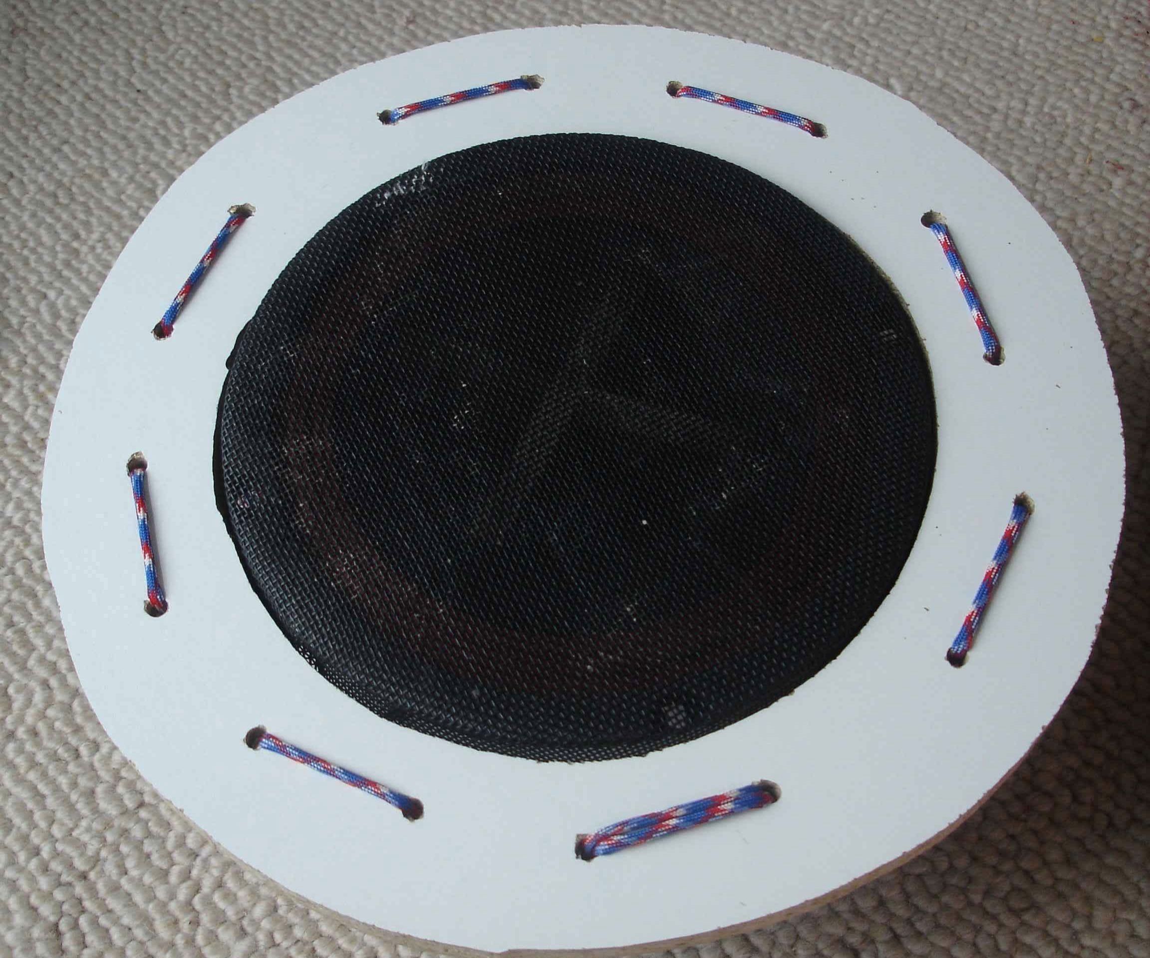

Introduction: Simple Flip-Flop Switch With Momentary Switch
Or , Fun withThyristors- this circuit came about through trying to make a footswitch controller board for some music software , a looper , which will be the subject of another Instructable. I'll show you the circuits that led up to the Flip-Flop so you can see how it works more easily. It contains only a few parts , and is dependable- there is no need for debouncing circuitry.
