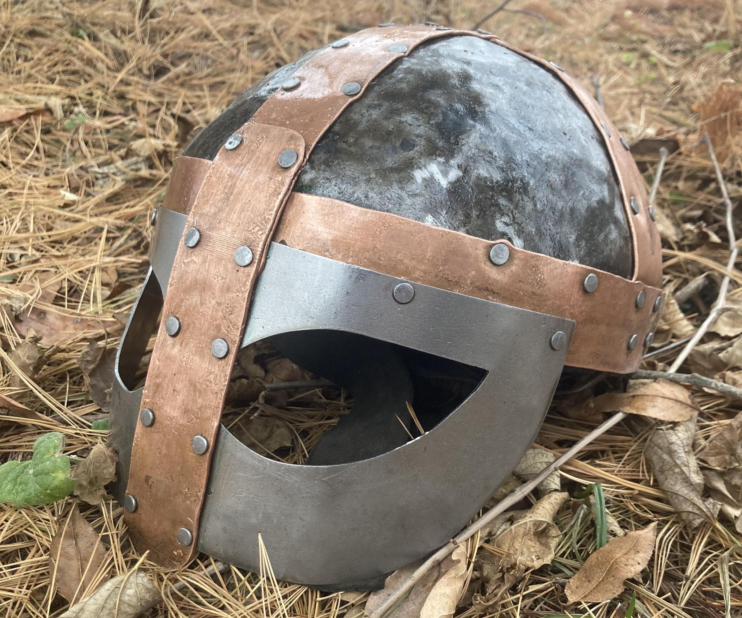

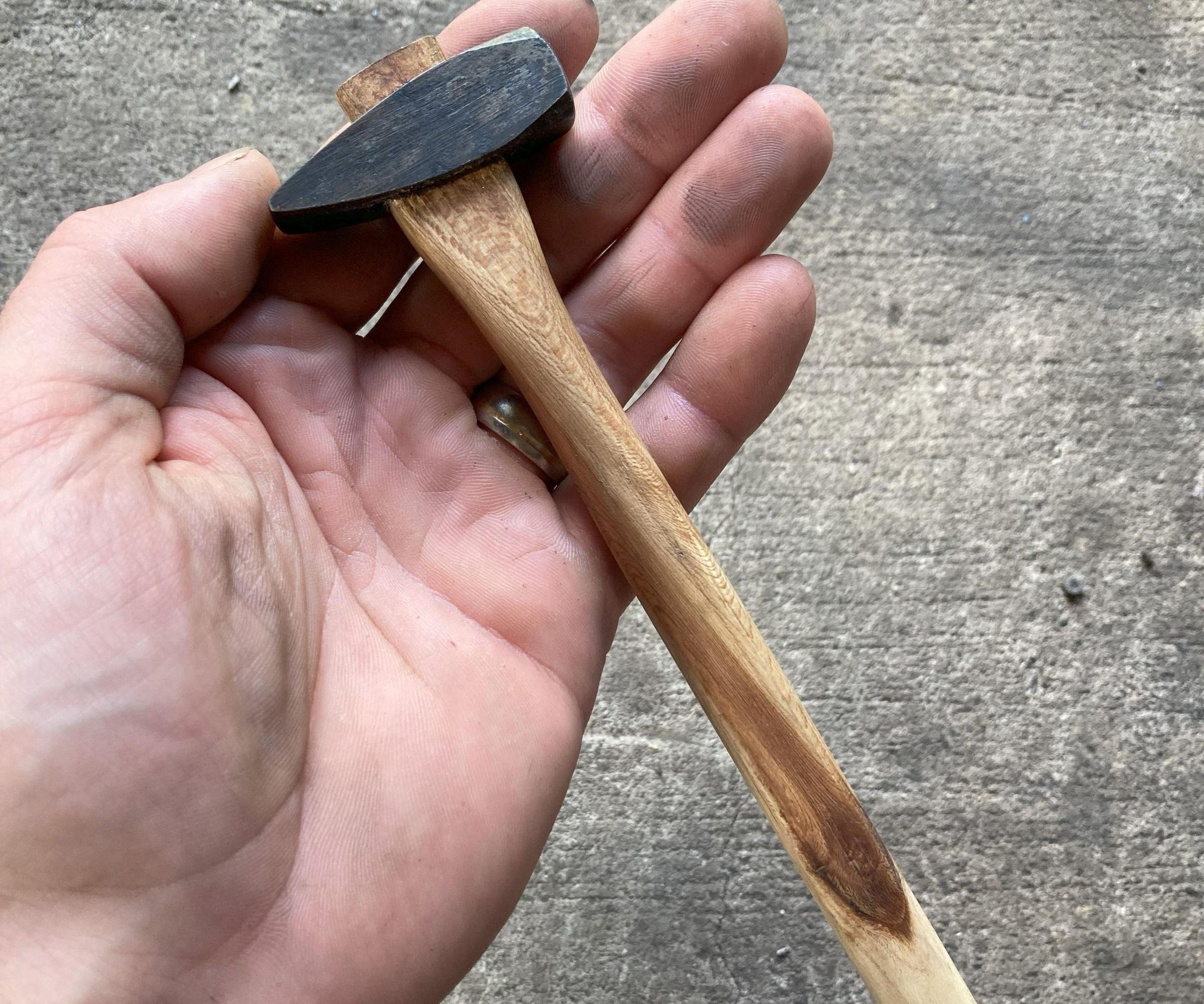

Obviously this is just a template. Throughout, there are probably better/different ways to do almost everything, but this is the way I built mine and I have made over 100 pieces on it from small pocket knives to full size swords to pendants to hammers. The single bellows reliably gives about a six to seven inch working heat meaning that this is about the size of the area you'll be able to work on at a time. More elbows and pipe ends might make the working area bigger, but I've never tried. The temperatures I've reached in this type of forge have been high enough make forge welds and even melt through steel bars at times so basic forging heats are no problem.
