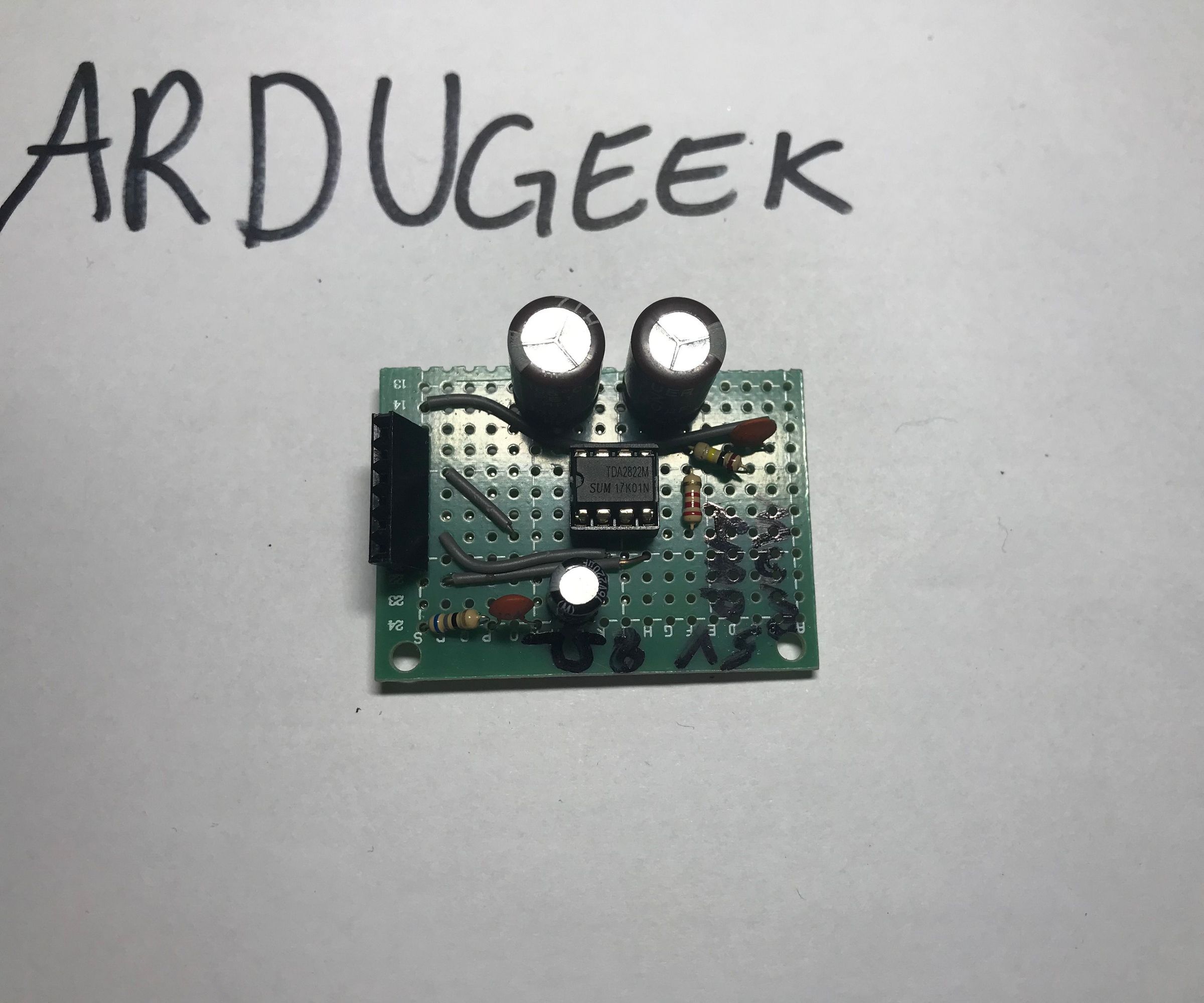

Circuit is easy to build it consists of oscillator and frequency selector. The wire that sticks out can be connected to male headers near capacitors, to set the frequency

Step 3: Build Filter
Filter is from my last instructable, but in this project i have soldered it on piece of perf board
