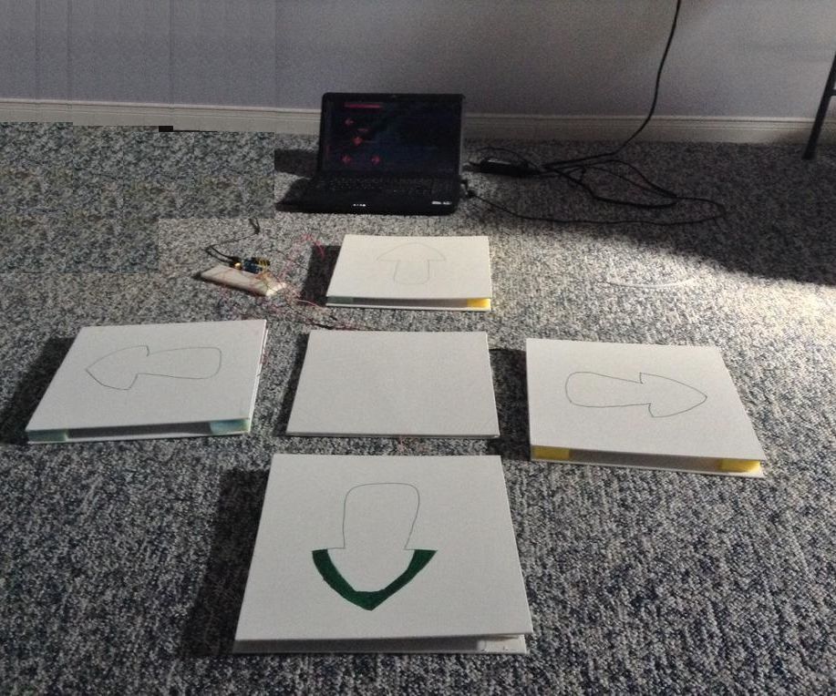

After making the Simple taped up DDR Pad, the natural next step is obviously a guitar hero controller :)
