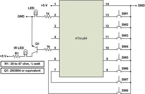

The IR Transmitter I originally made was just a breadboard tool so that I could generate the specific commands I wanted to program into a cheap learning remote. As seen in the pictures, I did make a usable remote for one of my projects. It’s battery operated so I used a low-power ATtiny85 circuit similar to what I used in my “ATtiny85 RF Remote” Instructable. For the IR remote I needed more power capability than in the RF remote so I used a 14500 Li-ion battery instead of a button battery. The 14500 is the same size as a standard AA battery but provides around 4 volts and can be recharged using most 18650 chargers. The circuit should also work OK with a pair of AAA batteries.
The hardware is pretty simple with the ATtiny generating a PWM frequency of 38-kHz that drives a small signal NPN transistor. The transistor, in turn, powers a common IR LED. The IR LED is one that I scrounged from a broken remote but they are cheap if you need to buy one. When I looked online at similar projects I found a wide variety of circuits and comments about the proper duty cycle and amount of current to apply to the LED. It really has to do with how much range you want for the remote. Keep in mind that we are applying short pulse bursts of current to the LED so it’s not the same situation as if we were turning it on for long periods. What I finally settled on was a 50% duty cycle for the 38-kHz pulses. I also wanted to keep the peak power below ½ watt so in my original prototype I wired a pair of 82 ohm, ¼ watt resistors in parallel for R1. Originally I used a single 75 ohm, ¼ watt resistor and that gave me a maximum range of about 14 feet. With the parallel pair of 82 ohm resistors (effectively 41 ohms) it worked at double that range.
I like to have a visible indicator of a button press so one of the ATtiny outputs is dedicated to blinking an LED when that happens. That only leaves 3 pins available for button inputs on the ATTiny85. If you need more than that, the ATTiny84 can provide 8 inputs. The provided software works for both chips. There is a “define” that needs to be uncommented to use it on the ATtiny85. The transmitted codes are set in the interrupt handler. There are three things to keep in mind when setting up the Arduino IDE for programming the chips. First, select the option for “no bootloader”. Second, select the option for the 8-MHz internal clock. Third, disable the "milli/micros" function. You will need to click on the “Burn Bootloader” command before loading the software into the chip. This actually sets the “fuses” in the chip for the selected options.
The ATtiny chips provide some dedicated pins for the PWM output. In order to gate the pulses on the selected pin all we have to do is to change the definition of the pin from an input to an output. To close the gate we simply change the pin definition back to an input. That is done on the fly in the software. There are “defines” at the top of the software for the number of microseconds needed to gate the pulses for each portion of the transmission. Even though we turned off the “millis/micros” functions, the “delayMicroseconds” command still works and that is what is used to time the gate periods.
