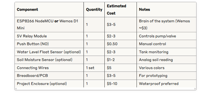

Step 1: Gather Your Parts
Essential Components:
  1. ESP8266 NodeMCU or Wemos D1 Mini
  2. 5V Relay Module
  3. Push Button
  4. 12V Water Pump
  5. 12V Power Supply
  6. DC-DC Step Down Module 12V→5V
  7. Connecting wires and breadboard
Optional Sensors (you can add them later):
  1. Water Level Float Sensor ($2-3)
  2. Soil Moisture Sensor ($1-2)
