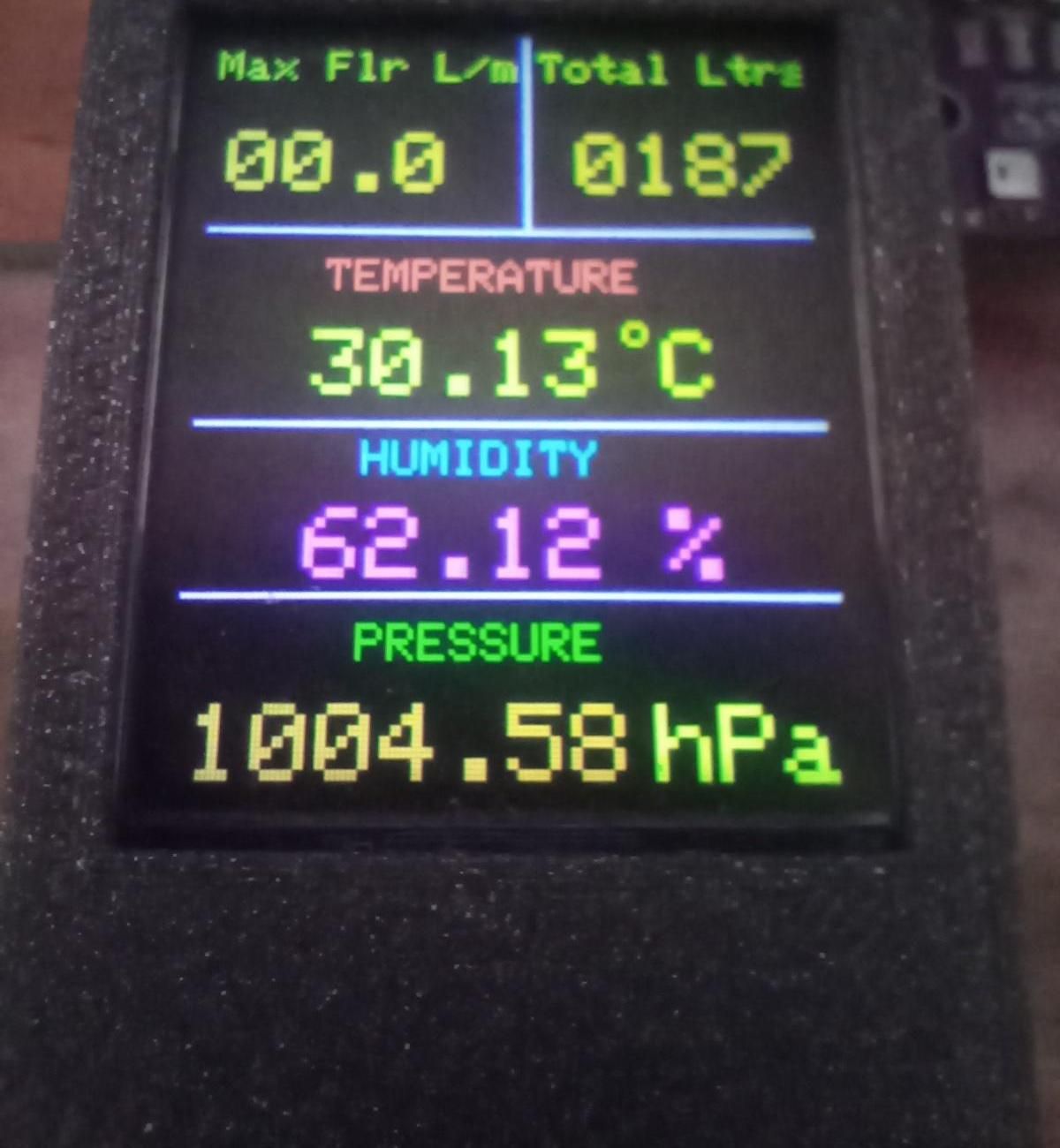

Step 2: Caution Points and Code
This program has been running for over five years. There are some points that need extra caution to prevent issues. Firstly, a central control valve must be installed to prevent the system from watering continuously due to a faulty valve left open. Secondly, it needs a monitoring system to ensure the system works properly and meets our needs. In fact, a second program could control the main valve to prevent watering on rainy days. I made a second Arduino IoT device that handles several requirements and presents data on a TFT screen but you must have WiFi nearby.
