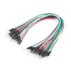

  • Jumper wires

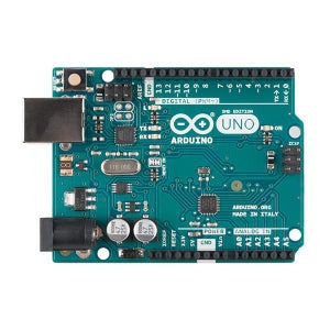

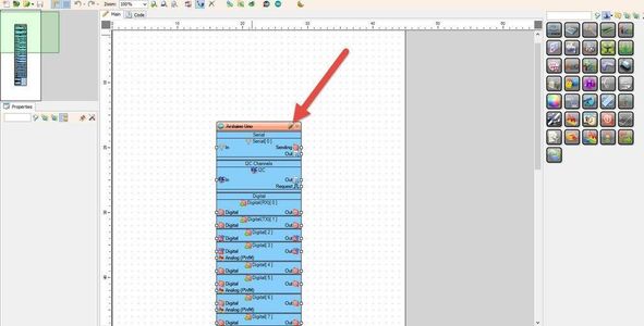

Step 4: Start Visuino, and Select the Arduino UNO Board Type
Start Visuino as shown in the first picture Click on the "Tools" button on the Arduino component (Picture 1) in Visuino When the dialog appears, select "Arduino UNO" as shown on Picture 2

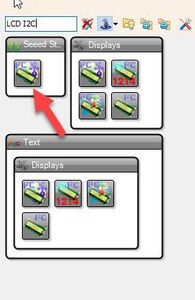

Step 5: In Visuino Add Components
  • Add "Liquid Crystal Display (LCD) - I2C" component

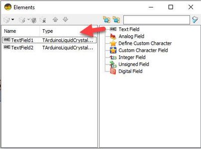

  • Double click on the "LiquidCrystalDisplay1" and in the "Elements" window drag "Text Field" to the left and in the properties window set "Column" to 3, "Row" to 0, "Width" to 17, "Initial Value" to BATTERY LEVEL
  • Drag another "Text Field" to the left and in the properties window set "Column" to 1, "Row" to 2, "Width" to 17
  • Close the "Elements" window

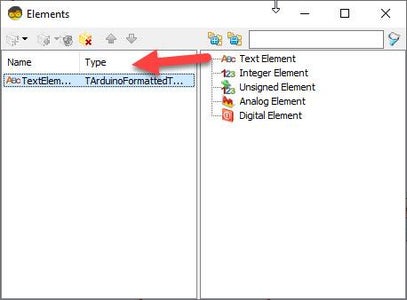

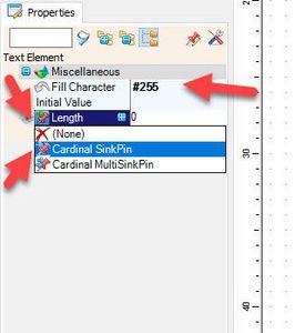

  • Double click on the "FormattedText1" and in the "Elements" window drag "Text Element" to the left side and in the properties window set 'Fill Character" to #255 and select "Length" and click on the pin icon and select "Cardinal SinkPin"
