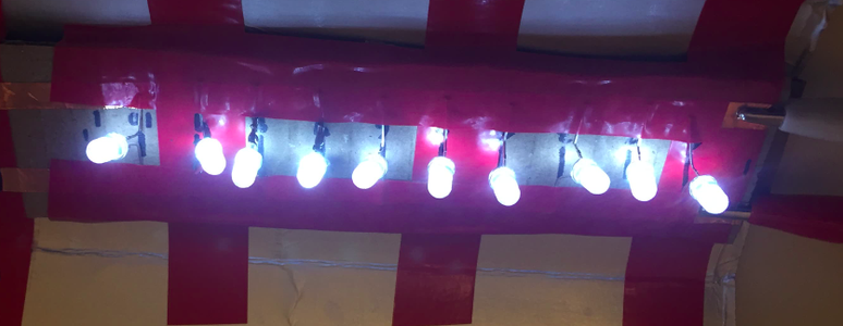

Step 4: Step 4: Place and Attach Your LEDs to the Base of Your Lamp
This step requires some manual handling skills as the insulating tape and thin LED legs can get a bit fidly. But after 1 or 2 LED's are fixed you will get the hang of it!
- Pre-fold the legs of your LEDs outwardly so that when placed on your base, they fully touch the copper strip on both sides.
- Make sure the positive LED leg touches the copper strip you assigned as "positive" and vice-versa.
- Cut a large strip of insulating tape (an inch smaller than your copper strips).
- Do only one side first (in the picture I did all the positives first).
- Take each LED and, one by one, attach the positive leg to the the positive copper tape, covering it with the insulating tape.
- Use your finger and nails to make sure the insulating tape is pressing on the LED leg
- Repeat with the other side.

Step 7: Step 7: Switch Your Lamp on and Off and Test Out Switches!
Now it is time to test your lamp by making an alligator clip quick switch (see picture for further details):
- connect your third alligator clip (black in the picture) to Makey Makey ground strip
- connect your fourth alligator clip to one of the arrows (left arrow in the picture)
- touch both remaining ends to create a "switch" that will close the circuit and turn on your LED Lamp*
