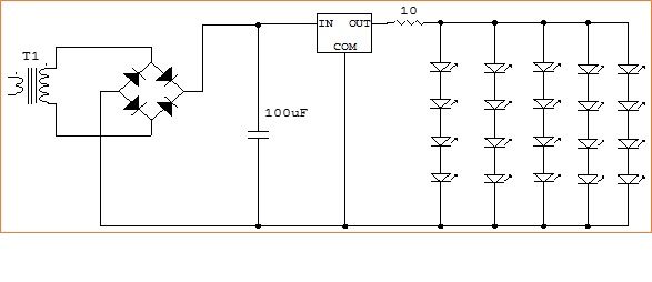

For construction of LED light you have need some components as per following list.
1) LED 20 nos.
2) Transformer 12v. 1 no.
3) Capacitor 100uF/25v 1 no.
4) Diode 1N4007 4 nos.
5) P.C.B. 1 no
6) Regulator IC 7812 1 no.
7) Resistor 10 Ohms/1W 1 no.
You first test all the components whether good or bad if found any components is bad then replace that then assembling it as per circuit diagram on PCB. When you use electronic parts those parts should have correct values, watt and voltage.
