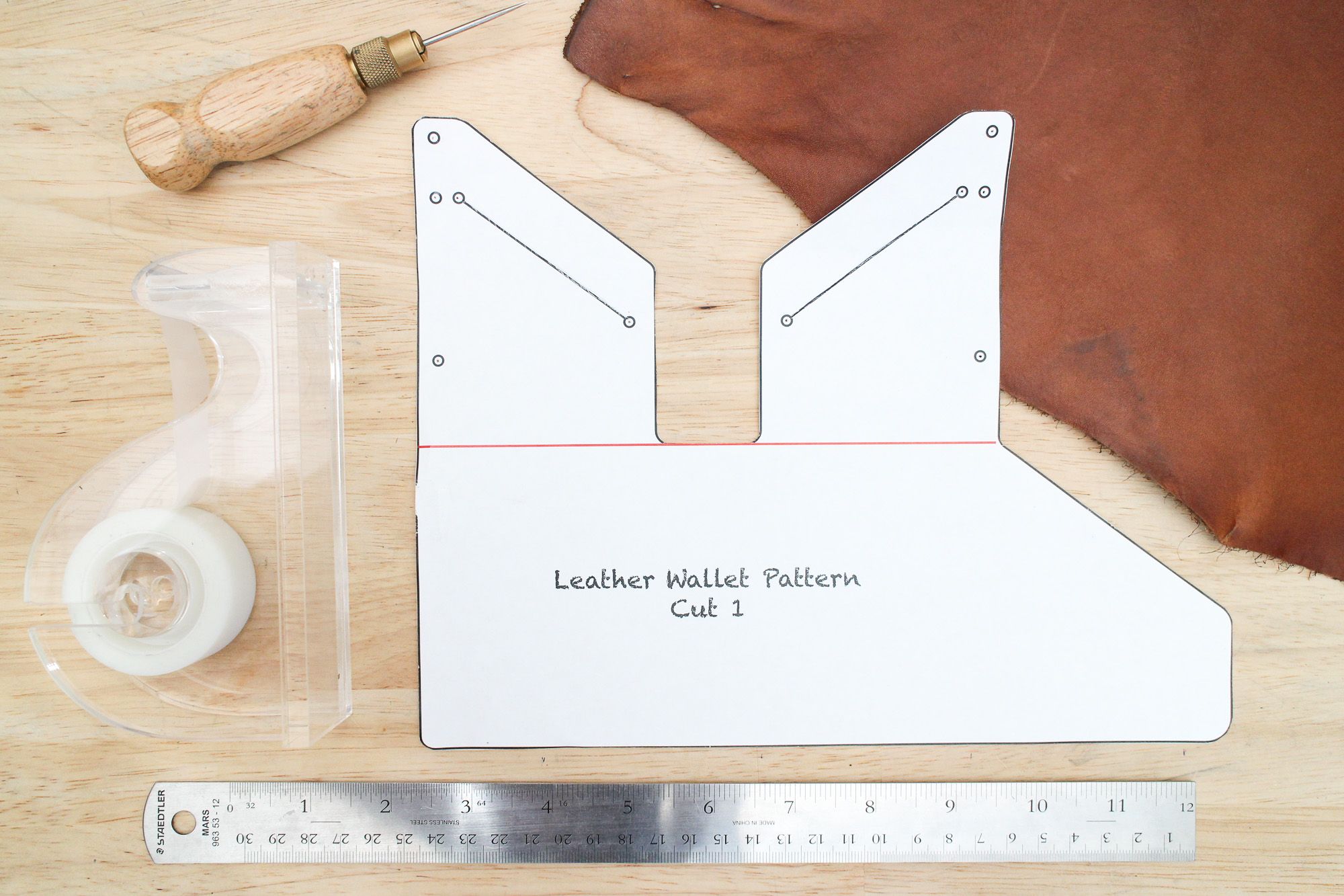

In this lesson I'll show you how to transfer a paper pattern onto leather. Before we get started, assemble the tools and materials you need on your work surface and get comfortable. Print out your wallet pattern on paper and cut it out with scissors. Make sure when you print out the pattern, you have it scaled to 100% so it will be the right size. Also, If you can, print it on cardstock or thick paper, this will make it easier to trace the pattern onto leather.
In this lesson I'll be using:

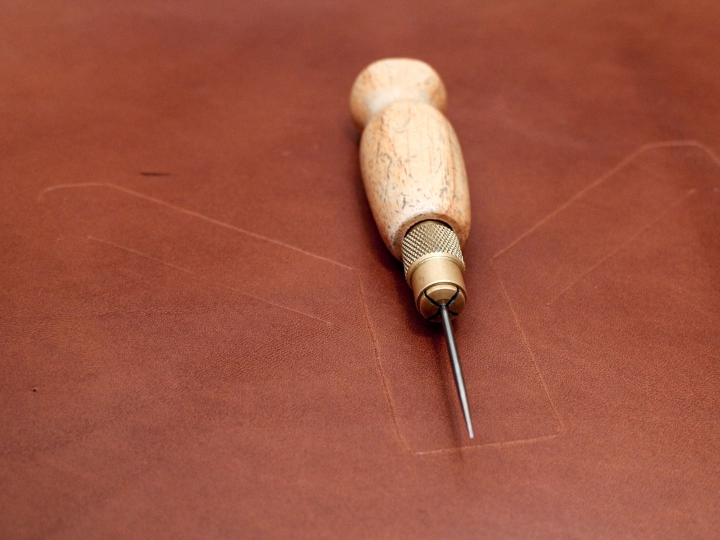

If you sew, you know that you usually cut and mark fabric from the reverse side, but when you're working with leather, you often mark on the grain side. This is mostly because you mark by making a scratch on the surface of the leather, and you can see this type of mark better on the grain side. It's also best to cut leather from the grain side to get the cleanest cut, and this means you need to make visible guide-lines on the side you're cutting.

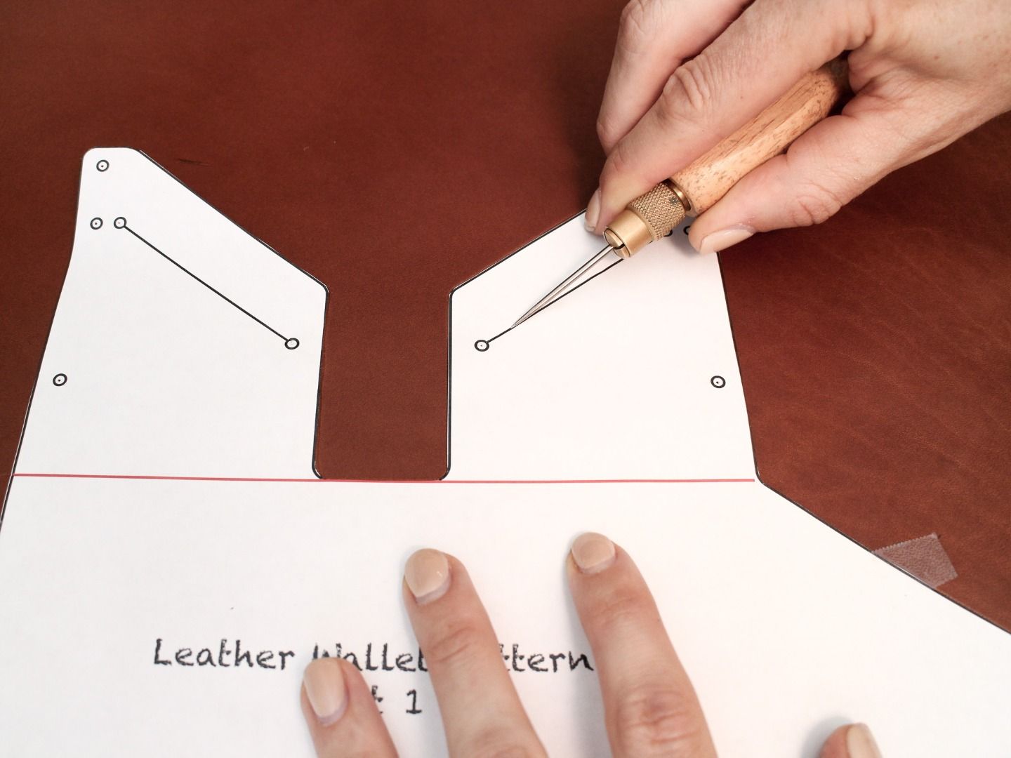

First lay your leather out on a flat surface with the grain side facing up. If you have a large piece of leather, you might want to weigh it down with something to keep it from shifting around. Place the pattern piece on your leather, somewhere close to the edge so you are making the most efficient use of your material.

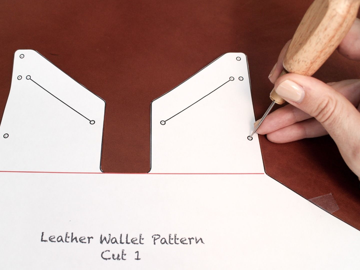

You don't want to pin down your pattern piece here as you would with a sewing pattern on fabric. Any hole you make in leather will remain visible forever after, so pins are not a good idea. (Also, it's very difficult to stick pins into leather). As an alternative, I usually use a few small pieces of scotch tape to hold my pattern pieces down. Just two on a pattern piece is usually enough to hold it in place as you trace.
The tape will leave marks on the leather, so only stick it in areas that won't be part of another pattern piece. If you've cut your pattern out of cardstock or oak tag, you can sometimes get away without using tape and just holding your pattern piece in place, but I still think a little tape is a good idea.

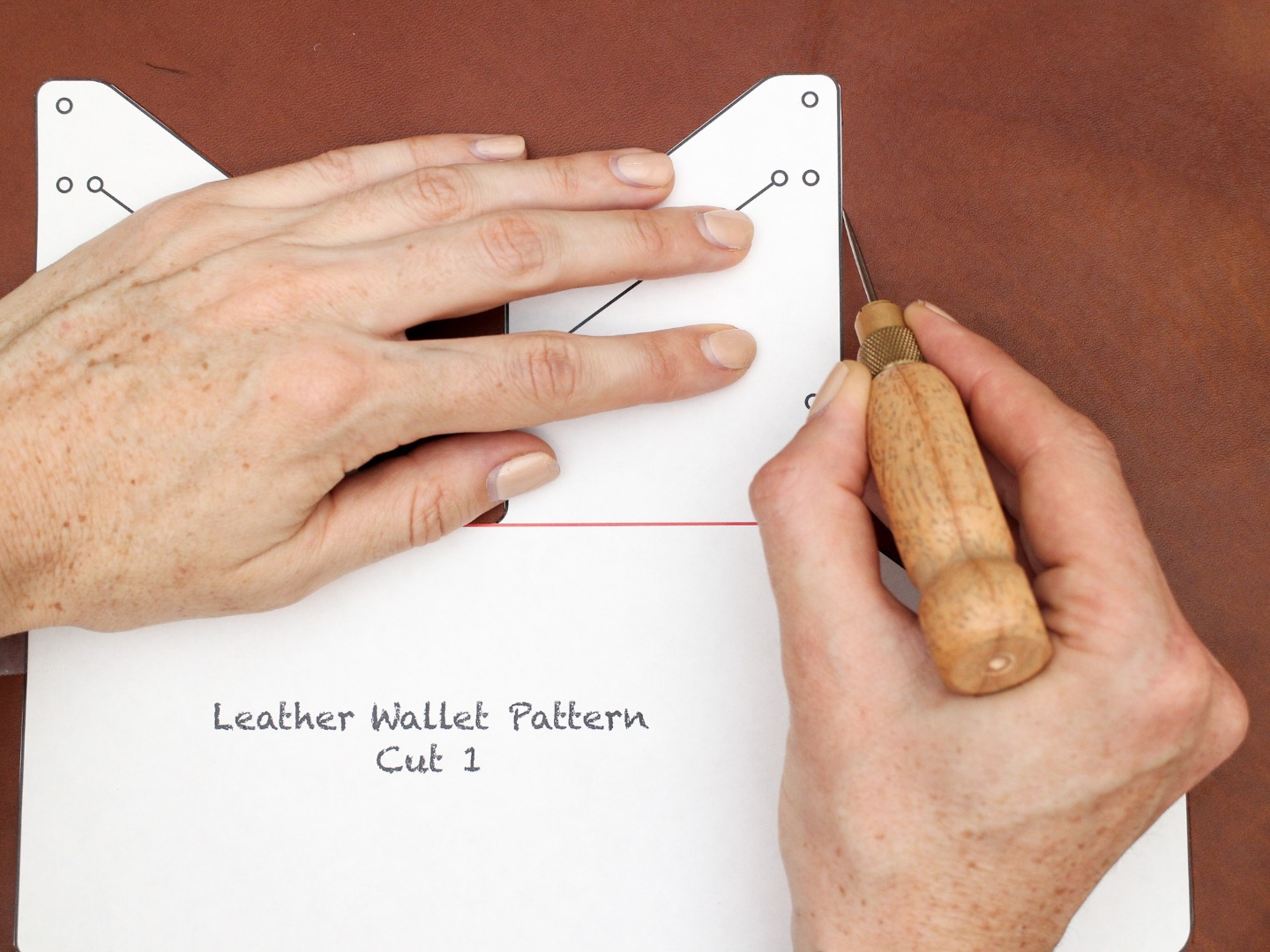

Now take your awl and trace around the edge of your pattern piece while holding it down with your other hand. You don't need to press down too hard with the awl, just hard enough to make a visible mark on your leather. Having your pattern in thicker paper comes in handy here too because your awl has a firm edge to follow. When you have traced all the external lines, use the tip of your awl to mark the center of the rivet and snap holes marked with black circles on the pattern, and the black internal cut lines for the card slots. Don't mark the fold lines that are shown in red, we will mark those later.

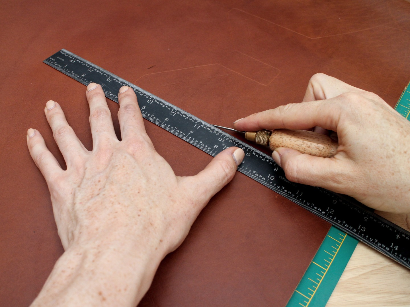

Now, remove the pattern from your leather, checking that you haven't missed any lines. To get perfectly straight lines on straight edges, I also sometimes just mark the corners, and then trace the lines with a ruler after removing the pattern.
