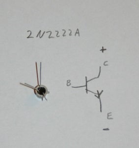

I know how difficult it can be to figure out which lead is which when comparing a "real device" to a schematic, so I am showing the transistor and LED here.
