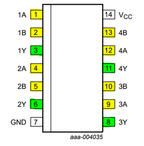

Step 1: General Principle
Basically, logic gates work by having two inputs and an output based on the state of the two inputs. In the left figure, I have marked the inputs in yellow and the outputs in blue. In the right figure I marked the inputs yellow and the outputs green. If you start from the top left point of both IC's you see that there are two different arrangements of the pins. On one the output comes first and then the inputs and on the other it is the other way round.
What logic the IC's contain is therefore not so important. I wanted to test NOR-gates with the blue arrangement and AND-gates with the green one but every logic gate IC with the same pinout can be tested with it.
VCC (in our case 5V) is connected to the upper right and GND to the lower left. This is the same for most IC's.
