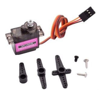

- Micro Servo SG90 (Metal Gear is recommended)

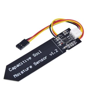

- Capacitive Soil Moisture Sensor

Watering can be done in a regular interval or can be based on the soil moisture. I took the second option and for this moisture sensor is required. So, I made a 3D model for housing the sensor, a micro servo motor and inserting the water pipe. The logic is that, moisture sensor will read the moisture content of the plant pot and based on the moisture content the servo motor will be rotate to block or allow the water flow through the water pipe.

- Insert the capacitive soil moisture sensor to the base
- Guide the sensor cable
- Insert the pully to the servo motor and add the screw.
- Place the servo motor to the servo slot
- Attache the servo screws
