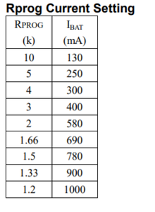

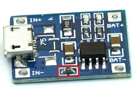

Step 2: Comments on LiPo Charging Module
In this small project I used a small and thin 400 mAh LiPo battery. To charge it properly, I changed the R2 resistor of the module from 1.2K to 3K ohm to reduce the maximum charge current from 1A to 400mA.
