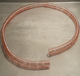

Step 2: Making the Coil
To start, we're going to make the coil that the magnetic train goes through. To make these you need a tube with a diameter slightly larger than the diameter of the magnets. I was lucky and had a plastic pipe in the shed that was suitable for this.

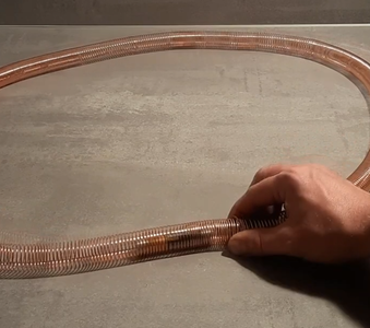

Twist the copper wire tightly around the tube. The twists should also be tight against each other.
To make it a bit easier I put the plastic pipe in a bearing and powered it with the cordless drill. Mat the hand also works, but this way is much faster!
Carefully remove the coil from the tube and gently pull the coils apart. The gaps between the turns must not exceed the thickness of the magnets.

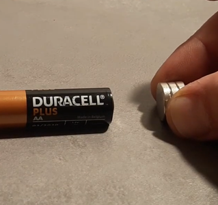

Step 3: Making the "train"

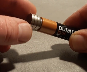

Place three magnets on either end of the battery. You need to make sure the north poles (or the south poles) are facing each other when the magnets are attached to the battery. At the + side I have placed an iron ring in between for stability. This is not necessary.
Note: The batteries are very strong and can cause good pinch blisters! Don't let your fingers get in between them.
