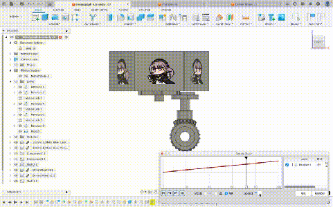

Step 1: Designing the Mechanism
When I first designed the mechanism, I made a test mechanism to see how I would need to design the structure to support it and learn animation skills on Fusion. For this I had a simple crank connected with a 48T Bevel Gear that drives a 12T Pinion, creating a 1:4 gear ratio. This is then supplies the rotational motion to a 6 slot geneva drive. For designing the actual mechanism, one tweak I made is that the 12T Gear was to be printed as a part of its shaft so that the rotational motion to be transferred to the geneva drive easier and changed the geneva drive from 6 slot to 10 slot.

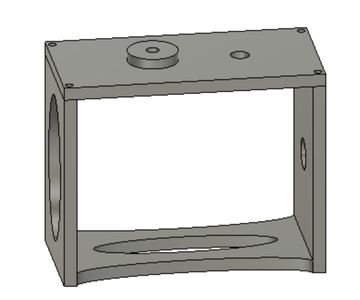

Step 2: Designing the Structures
For designing the structures, the frame is made in two parts that connected via M3 screws. Holes were added to the left side and bottom for assisting in holding and also reducing the amount of filament needed. For the platform that shows the animation, it is connected to the driven wheel of the geneva drive via a hex shaft and the walls make a decagon shape to have 10 frames. If you want to make a platform for your own animation, the height of the walls may have to be adjusted to fit the frames. One issue I had while testing the animation mechanism is that the driven wheel rotated too much compared to the drive wheel which caused the mechanism to get stuck. Thus to reduce the angular momentum, the size of the platform was reduced which fixed the problem.
