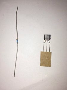

Parts:

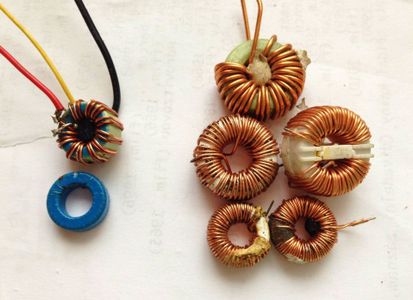

ferrite toroid(broken CFL, motherboard...)
2N3904 transistor
magnet wire(I've used 0,5mm)
insulated copper wire(10 cm length is enough)
240Ω small 0,25W resistor
LED(I've used 10mm red, optional)
If you don't have 2N3904, then you can use 2N2222 or just any common NPN. For the base resistor 240Ω possible substitutes are any value between 200Ω-1000Ω
I'll be using molypermalloy powder core
Dimensions:
Outside Diameter : 12.5mm
Inside Diameter : 7.5mm
Height : 5mm

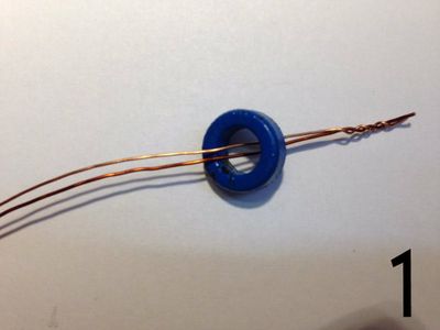

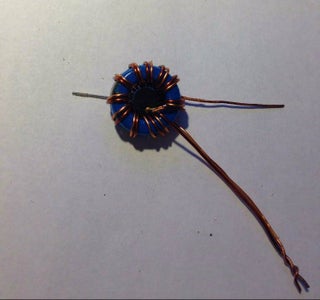

Start by taking two similar pieces of magnet wire. Normal insulated wire can be used too but takes more space and is less effective. You will need to know which wire is which when you finish winding. You can use magnet wire with different colors(like me) or you can use an ohmmeter. When you have the wire then you can begin winding.

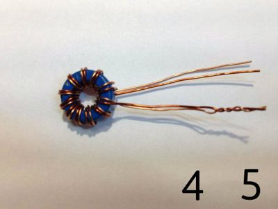

1) Twist both ends of the wires (makes winding easier)
2) Wind the first turn (hardest part)

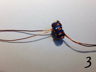

3) Continue by winding more turns.
4) Wind 8-12 turns.

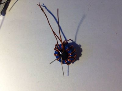

5) Check that the wires are not crossing and every turn is close to the core.

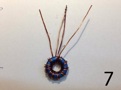

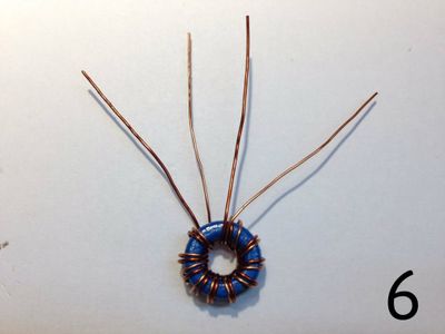

6) After winding you will have 4 wires coming from the toroid as shown.
7) Take the two inner ones and strip the of insulation (or enamel) make sure they are different color and twist them or solder them together to form a center tap.
After you complete these steps, then you can proceed to testing.

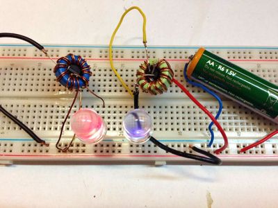

Step 4: Testing Toroid on a Breadboard

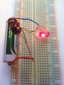

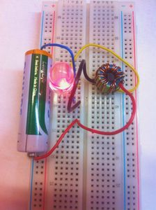

After winding I recommend to test everything on a breadboard. Then you can just leave the joule thief like this on a breadboard or you can make a PCB for it or you can proceed to the next step where I will be showing how to stuff components into the toroid.

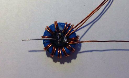

Step 5: Making It More Smaller

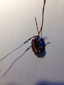

There isn't much to say here. Just stuff in all of the components into the toroid to make it smaller and thus usable in a small battery powered devices like for example bike light. You can do it your way or follow my instructions in images. Every time I do this i do it a little different.
Step 6: Try It Out
Solder some wires to your new miniature joule thief and you are done. You can also use hot glue to secure the components. Feel free to experiment with coils or even try to make it smaller or fit in a more complicated circuit made from SMD components.
