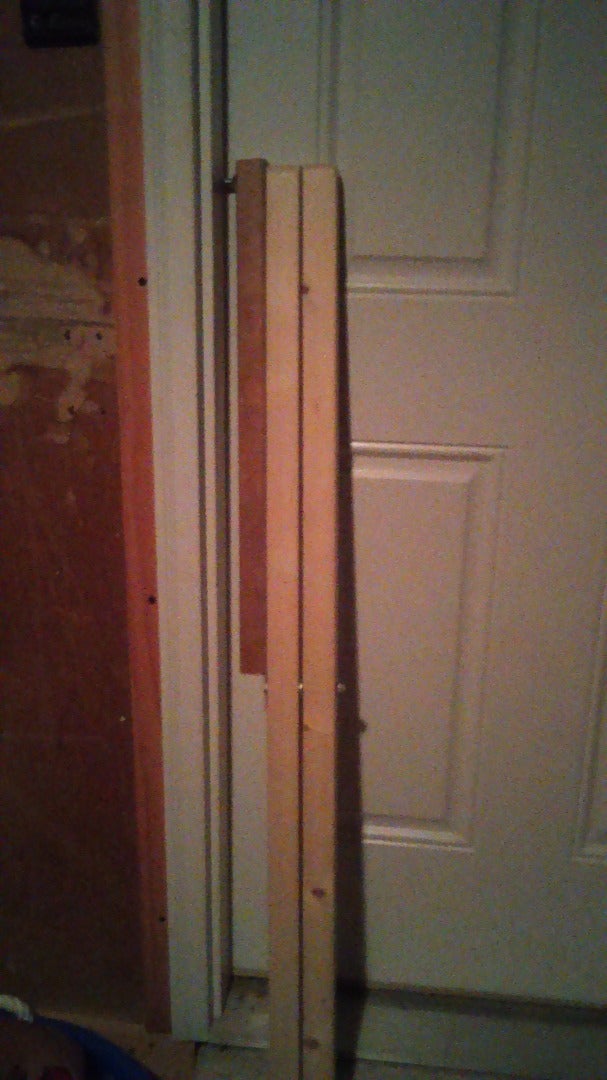

Step 2: The Legs: Part 1
To begin, take one of the two 8 foot 2in x 2in boards and measure 45in from one end. Mark and cut this spot. Measure again 45in form on end. Mark and cut the spot again. Now you'll have two 45in leg and a 6in stub. KEEP THE STUB. It will be used later.
Repeat for the other board to bring the total legs two four and the stubs to two.
Now measure 1ft 10 in (22in) from one end of the 54in board. Mark and cut. Again measure 1ft 10in (22in) from one end. This will give you two sides and a stub. KEEP THIS STUB.
