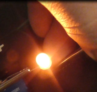

Take your partially cooked LED and connect the anode long side to the cathode "line" side of a regular diode and together with the help of the wire clips. Then connect the two remaining ends contacts together with another wire clip (the loose length instead of just connecting the two diodes together, The wire length between the two diodes act as a sort of crude loop antenna) Now take your 1.5 volt battery and connect the + side of the battery to the plus side of the circuit( the longer LED pin) and do the same with the negative side on opposite end. You will notice you do not have enough power to turn on the LED light. This is normal. The DC battery will be our amplifier DC bias power source.
Step 3: Testing the Circuit
Let's compare
Experienced users may skip this part. If you have a regular LED and have never played with simple RF diode detector circuits. May I recommend that you take the extra step to first experiment with that. Simply connect a regular LED to the circuit instead of the cooked one. Place your FRS antenna 1 inch away from the LED. Press the transmit button and you will see the LED faintly light up. This is because LEDs are also diodes and this only diode circuit acts as a crude AC to DC power supply (rectifier circuit) energized by the nearby RF as a form of AC provided by the FRS radio or other nearby transmitter. Cool!
Now run the circuit as intended with the cooked LED and you will notice much more brightness! As it behaves like an AC amplifier. read bellow.
Now running the circuit.
Make sure everything is connected as simple as a circuit this is. Connections may get loose. Now push on the talk button of your FRS radio or similar transmitter ( The 6 inch *give or take* connecting wires act as a good resonant antenna at the UHF frequencies) You will notice your cooked LED lights up nice and bright at normal color and you can pull the radio several inches away before it dims out once it is lit and starts amplifying! That is the LED is acting as a negative resistance diode amplifier and doing the job amplifying the RF/AC signals with the help of small DC bias supply and making it's own LED emit a bright light as a side effect. Cool!
