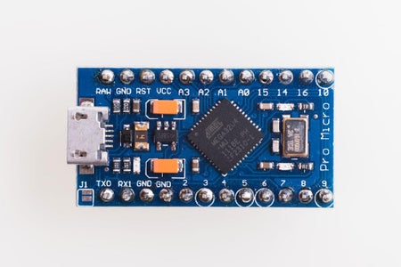

1 x Arduino pro micro LINK

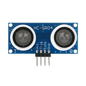

1 x HC-SR04 sonar sensor LINK

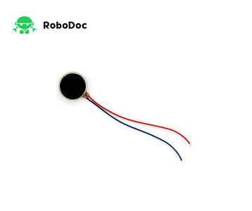

1 x Coin Vibration Motor LINK

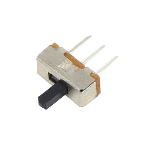

1 x sliding switch LINK

I won't go much into the theories. It basically detects by sending a pulse of ultrasound (freq > 20kHz) and measures the time delay between sending and receiving the pulse. By doing some simple calculation it measure the distance.

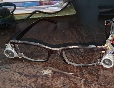

The sensors are tilted slightly before mounting on the sunglass to ensure proper detection. I made some tests before securing the sensors firmly using hot glue.
To learn more about how this topic checkout this link at instructable
Step 2: Detach the Sonar Sensors
I used a soldering iron to remove the sensors. Then I soldered wires for extending the connection.

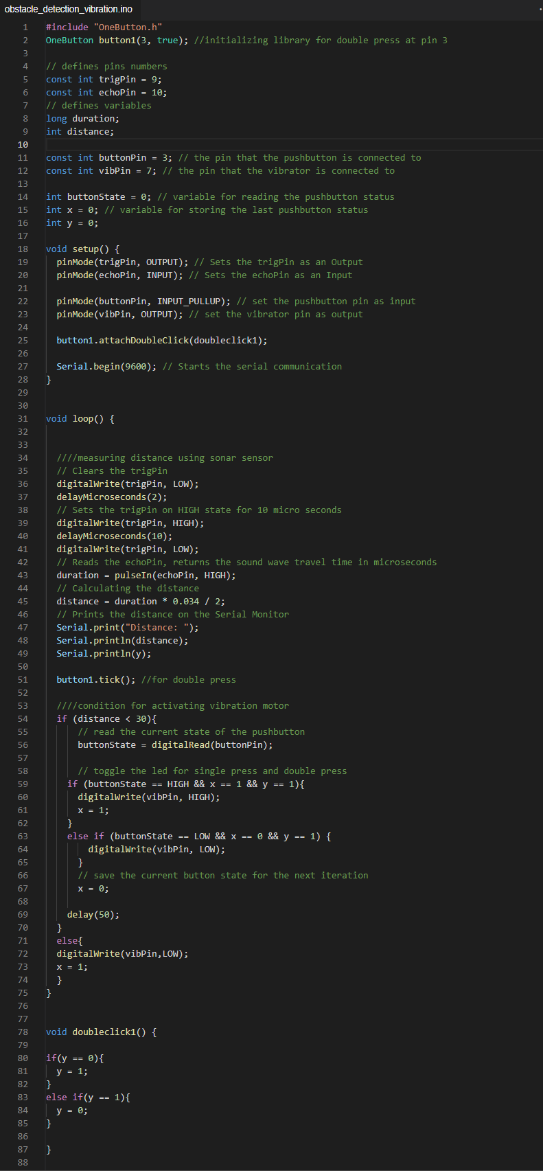

Explanations of the code are added as a comment after each line of the code but the basic theory is:
  • At first variables and constants are declared to store different pin numbers and values for usage in the later part
  • A library "onebutton.h" is also added for detecting double press
  • In void setup the inputs and outputs pin are declared.
  • in the void loop the code triggers and measures the distance. The distance is then put in a condition to check if the distance is less than 30 cm. Before sending signal to the vibrator, the code checks whether the button is pressed or not.
  • The last part of the code checks whether the button is pressed twice and changes a variable 'y'
You can download code from below link.
Step 5: Build the Device
Step 6: Complete!
I built this project back in 2019 and it received much attention. We even got featured by a TV channel! :)
