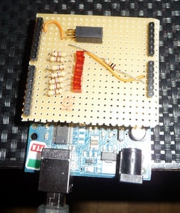

Step 3: Solder the Electronics Parts

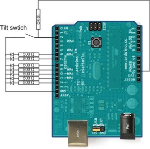

Solder the leds. The “upper” leds must be on the pin 6

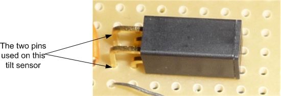

Solder the tilt switch and the 10 kohms resistor.
With my tilt switch, I’m using only two pins (see picture)
Add some jumper wire… and finally it should looks like the last picture

I think there is many way to improve this, by using interruption for example. For this purpose, I have connected the sensor on the pin 2 of the arduino of the external interruption.
