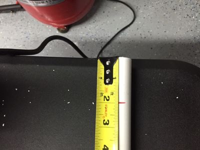

(9) Pieces of PVC 16-3/4"
(4) Pieces of PVC 7-3/4"
(4) Pieces of PVC 2"
(4) Pieces of PVC 4"

The base is (4) TEE's, (4) 90's, (4) 16-3/4" Pieces, and (4) 2" Pieces. Make a rectangle with the 90's on the outside and the (4) TEE's looking up. The 2" Pieces hold the 90's to the TEE's.
Then stick the risers into the TEE's. I used 36" Risers here.
