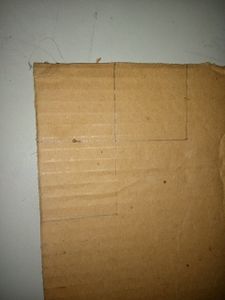

1. Cut a 5cm by 10cm cardboard . And a 5cm by 5cm cardboard.
2. Draw a cross as shown above.
3. Place the paper clip to the center of the cross. This will serve as a needle of the tracker.
4. Glue the 5cm by 5cm cardboard to the bottom of the tracker to secure the needle.
5. Place the bottle ring to surround the area of the tracker.
6. Fold the tracker in half. Will form a right angle as shown above. Glue to secure the angle.
