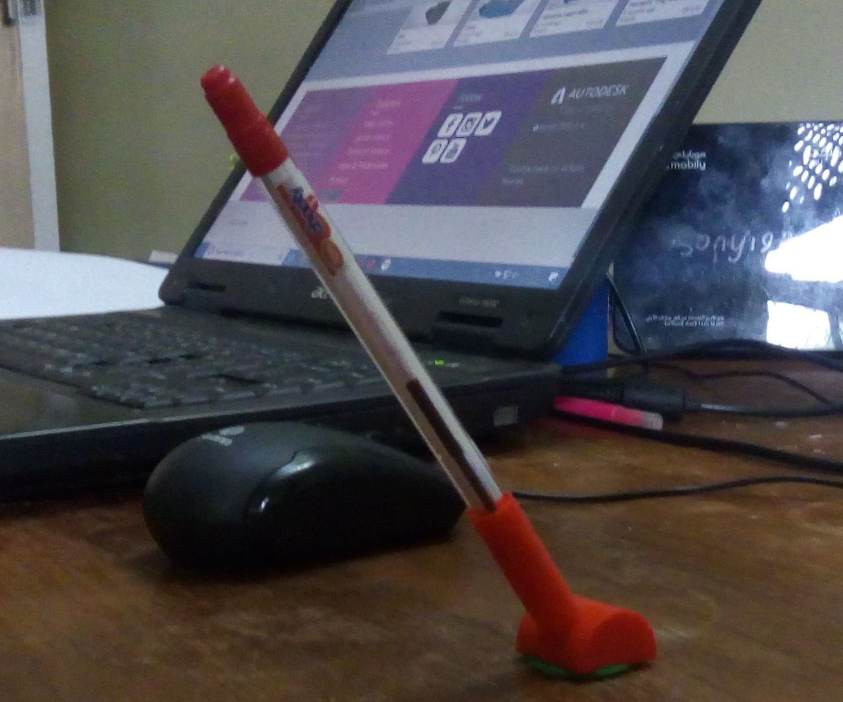

Today i am going to show you the design process of a simple phone stand and charging dock. This is a simple light weight phone dock and charging station

Step 9: Congratulations! You Have Completed This Build!
Hopefully this print turned out as expected. If you want to print a small test model to check the design. one is available linked to this step. Hope you enjoyed making this build.
