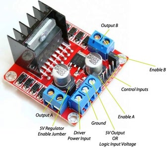

Step 2: The L298 Motor Driver
I have Mounted L298 Motor driver at the the bottom of my chassis, now to connect the DC motor and servo motor connect (i) DC Motor -A to output -A (+ & -)
(ii) DC Motor -B to output -B (+ & -)
(iii) Servo motor +ve to + 5V regulated supply of L298 Board & servo motor -ve to GND of L298 Board
keep the enable pin jumper as it is if you don't want speed control else remove the jumper, the jumper in place ensures +5V supply to enable pin which in turn drives motor at rated speed.

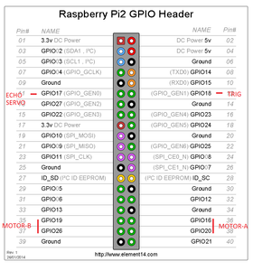

Now connect 4 nos jumper wires to the control inputs, connect other end of jumper wires to GPIO pin as designated in next step.
For servo motor connect one no jumper wire for control to GPIO pin as in next step

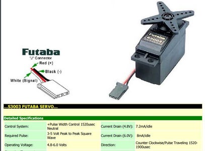

The servo has a 3 wire connection: power, ground, and control. The power source must be constantly applied
The control signal is pulse width modulated (PWM), but here the duration of the positive-going pulse determines the position of the servo shaft. For instance, a 1.520 millisecond pulse is the center position for a Futaba S148 servo. A longer pulse makes the servo turn to a clockwise-from-center position, and a shorter pulse makes the servo turn to a counter-clockwise-from-center position.
I have used Futuba s3003 servo - the connection is very simple the "+" & "-" goes to the L298 Board as outlined earlier. Its important to look at the operating voltage of servo ( in my case its 4.8 - 6 V see image above), the signal wire is to be connected to GPIO output , normally its white or orange

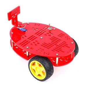

I have used Ellipzo Robot chassis with 2wd, 2wd are simple and easy to control to get started with lots of coding.
The kit comes included with DC Motors, pan kit for servo motors and all necessary hardware's to assemble the kit
The detailed link is available at - Ellipzo Robot chaisis kit

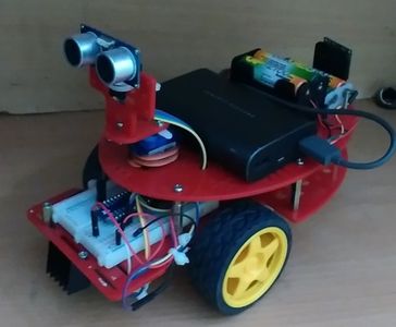

Pl refer to video for assembly of Raspberry Pi, along with L298 motor driver, the Breakout board , camera module and the power bank.
Step 5: The Distance Sensor
Integrating the distance sensor is easy and we need just 1k resistor along with jumper wires. Connect VCC & GND to pi +5Volts & GND respectively.
The other two pins TRIG & ECHO are to be connected to GPIO pins as in preceding steps
Remember to connect the resistor as shown in image.
The Python code to measure distance is included in the last step.

Step 7: Raspberry Pi Pin-out & Python Code
