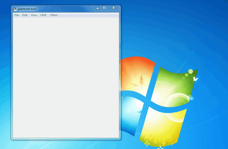

This is where plantuml comes into play. It has many functions (sequence charts, class diagramms, state diagramms, ...) but it is a command line tool which has to be fed with the source file as parameter or it is available as a web service.
I want to make rapid changes and don't like searching for my source files / output images or beeing not able to use it while not having the possibility to reach the web service.
Therefor I wrote a lightweight Python application which is attached in the following steps. Use it as a basis if you are anything like me and want to improve your programmers life with a small lightweight solution for code documentation.

Step 3: The Source Code (modification Needed!)
Here is my source code for the application. Look through it and try to understand it.
Modify:
- config (with simple editor)
- add full directory+filename for plantuml.jar in given python dict
- uml.pyw
- look for "###" in file (Strg+F for find)
- change file addresses for images (in directory icons) if needed
