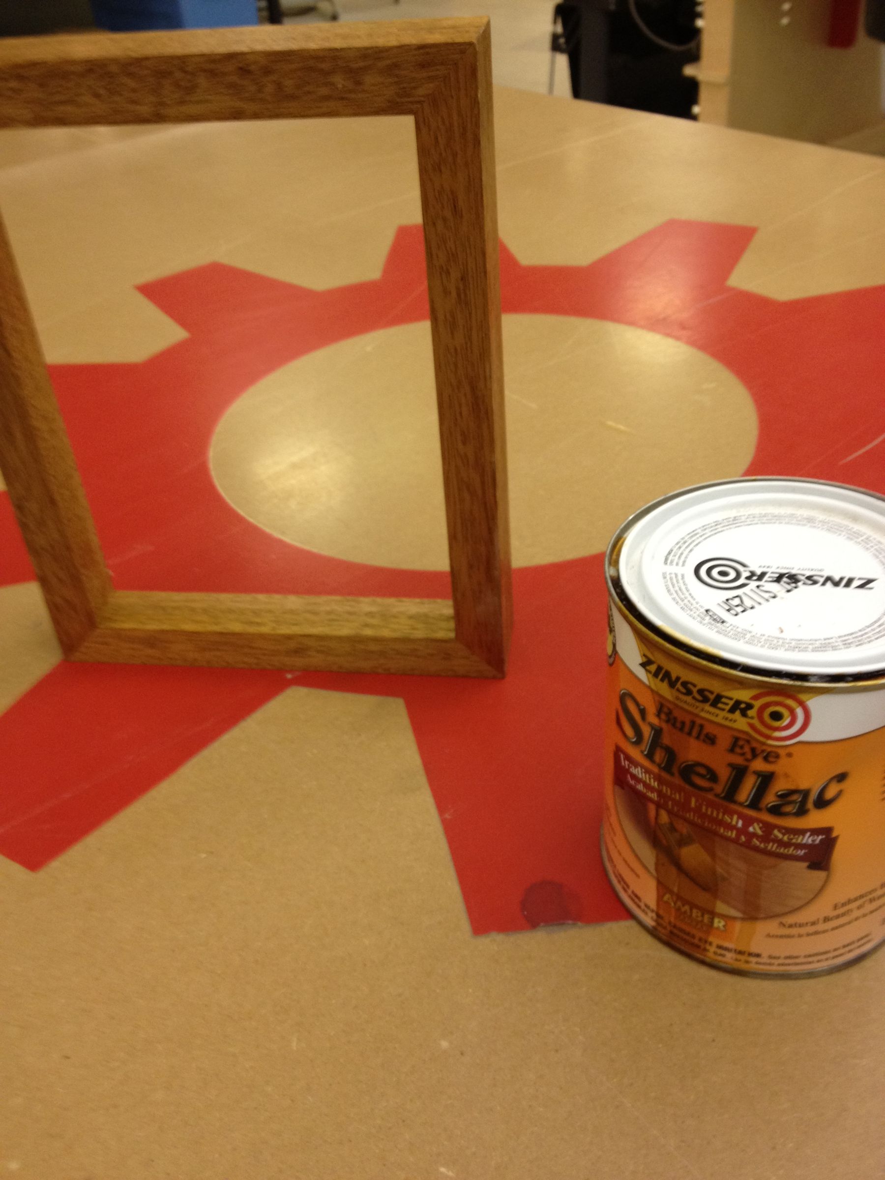

Fast and simple wooden boxes, I use them for my paintings. It saves me money by making them myself. You can make the boxes in any size that you want. For this instructable the box that i made was 6 x 6 x 2.125. I have also made 12 x 12 x 3.125 and 5 x 5 x 1.125.

there you have it a simple plywood box.
