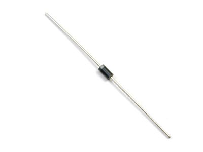

  • Two (2) LEDs (green and red or any other color)
  • Four (4) rectifier diodes (1N4007)/ any other will do fine

In the diagram, R1 represents the 1K-ohm resistor while the D3, D4, D5 and D6 represent the diodes (1N4007). The D1 and D2 are the red and green LEDs respectively.
