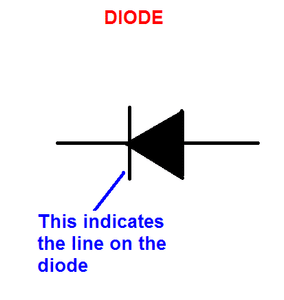

Step 2: How to Know How to Position Diode on Circuit Board
You should notice a white, Grey or other color banned on your diode, this is were it goes on a schematic.

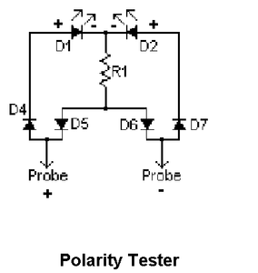

Step 3: The Circuit
-D1=Green LED
-D2=Red LED
-D4 to 7=Diode
-R1=1 k ohm resistor
-D2=Red LED
-D4 to 7=Diode
Step 4: Now Your Done!
Now that your done you can use it for any circuit testing under 12vdc.
