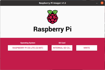

In this tutorial to install RPI OS on to the SD card I will be using “RPI imager” which can be downloaded here.
Press the the button below the label “Operating System”. In the opened window navigate to “Raspberry Pi OS (other)”. Then there select “Raspberry Pi OS Lite (32-bit)” version.
Also don’t forget to select the SD card where to install the OS. You can do that by pressing the button under the label “SD card”. When everything is selected, press the “Write” button and wait for the program to finish installing the OS.

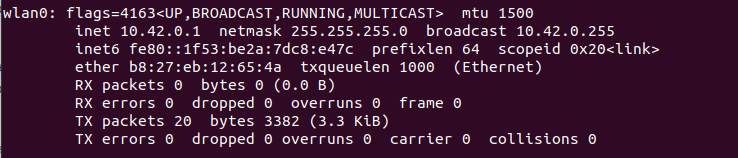

To check if our Access Point has an IP address you can use ifconfig once again and look for the interface by the name wlan0.

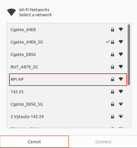

Take your device with wifi connectivity ant try to connect to our newly created Access Point. If you haven’t change the name of the Access Point, you should look for “RPI AP”.
