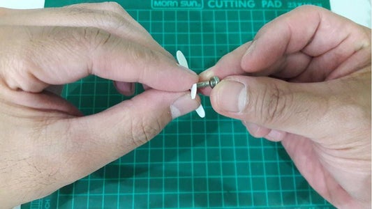

Step 3: The Prop
These few steps onward is to secure the prop for balancing.
I start by inserting the bolt into the prop's hole.
Note:
If you want to balance a nano drone's prop because it' is small, I suggest to use a pin.
Step 4: The Nut
Then, I loosely tight the bolt with the nut (make sure the nut is not too tight to the prop so that it can spin freely).
