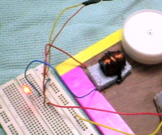

- Take the empty matchbox and stick the reed switch as shown in figure either using glue or staple pins and also stick the matchbox to board using adhesive.
- You can now mount rotor on the stand using pin and check if it rotates smoothly
Connect the reed switch with one end to induction coil and other to battery or adapter, which is connected to coil. You can also connect with bread board and test the neon bulb following the video. Reversing the direction of reed switch will result change in rotation of rotor clock or anticlockwise.
Ferrite Core Coil
Ferrite coil or air core (without ferrite can be used) for this experiment. Copper coil wingdings have nearly 450 turns with a cylindrical ferrite core inside. If you do not get ferrite, air core coil also works.One advantage in ferrite core is that it produces more energy with same current. More wingdings also will produce more energy. Attach the core to the board as shown in the video or any other way you like. Bring reed switch, rotor, ferrite core together in alignment and make connections as you can see in diagram or video.
