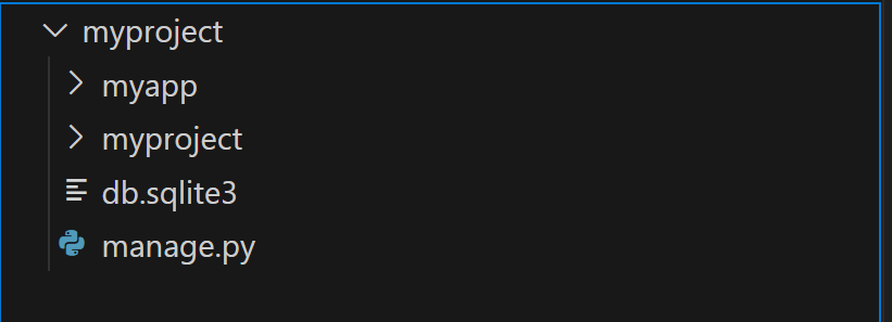

First, we are going to need to create a new directory called 'myapp'. This folder should be on the same level as the 'manage.py' file. See the above image. This directory will also need to be added to the 'INSTALLED_APPS' in settings.py similar to how we added rest_framework.
