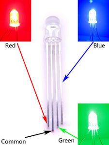

The longest leg of the LED is the anode. A diagram is attached showing the colours mapped to the legs.

RGB LED
1. Connect the common anode(longest leg) to the +5V pin
3. Connect the legs Red, Green and Blue to digital inputs 13, 12 and 8 through a resistor each
