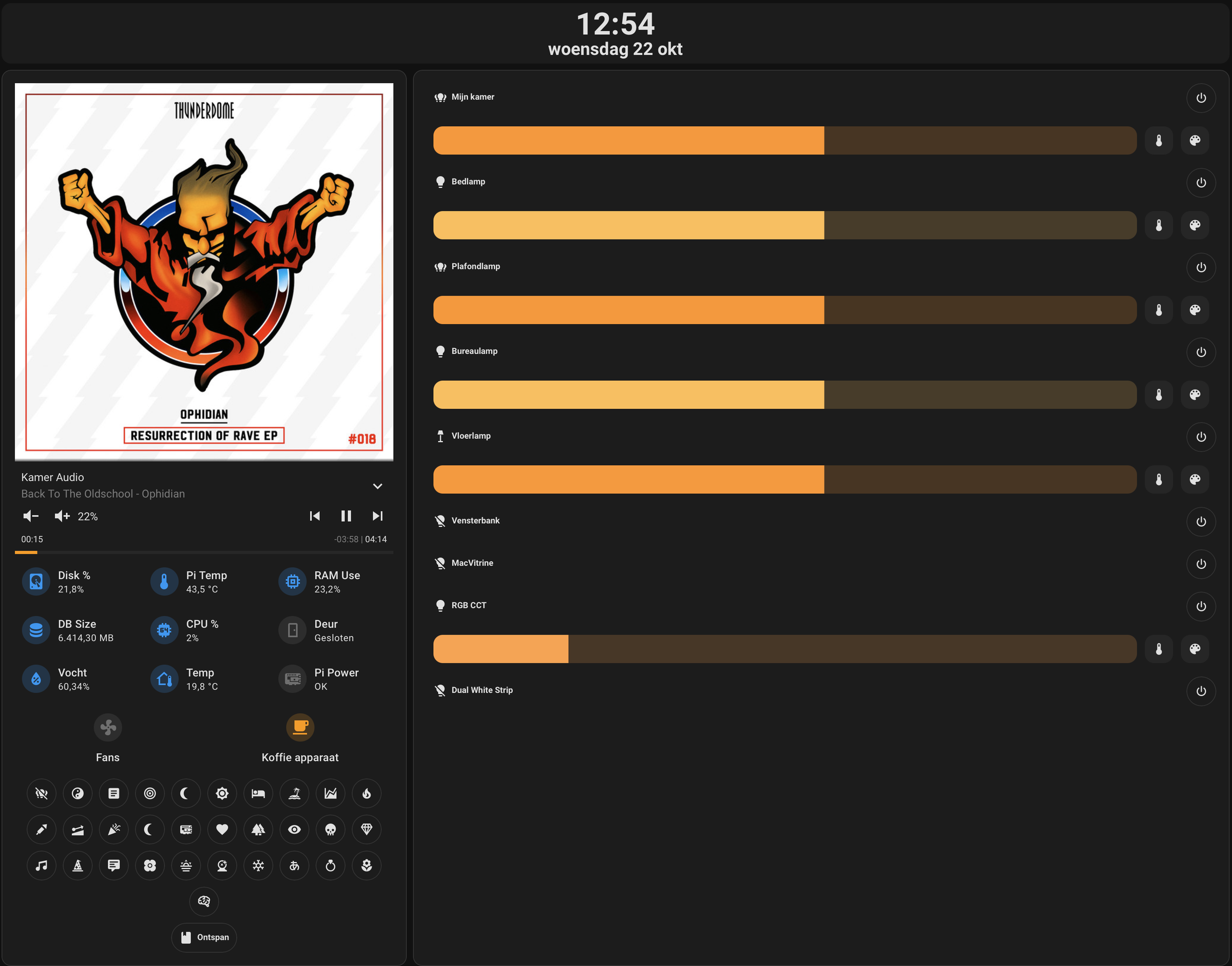

This LED-strip was a cheap Tuya strip that I bought at the Action (Holland) some years ago. I destroyed the controlled back then because I tried to reprogram the Tuya controller. After that mistake (haha), I wanted to use the LED-strip still by controlling it with ESPHome via home assistant. With help of a selfmade PCB and some YAML code, I succeeded!

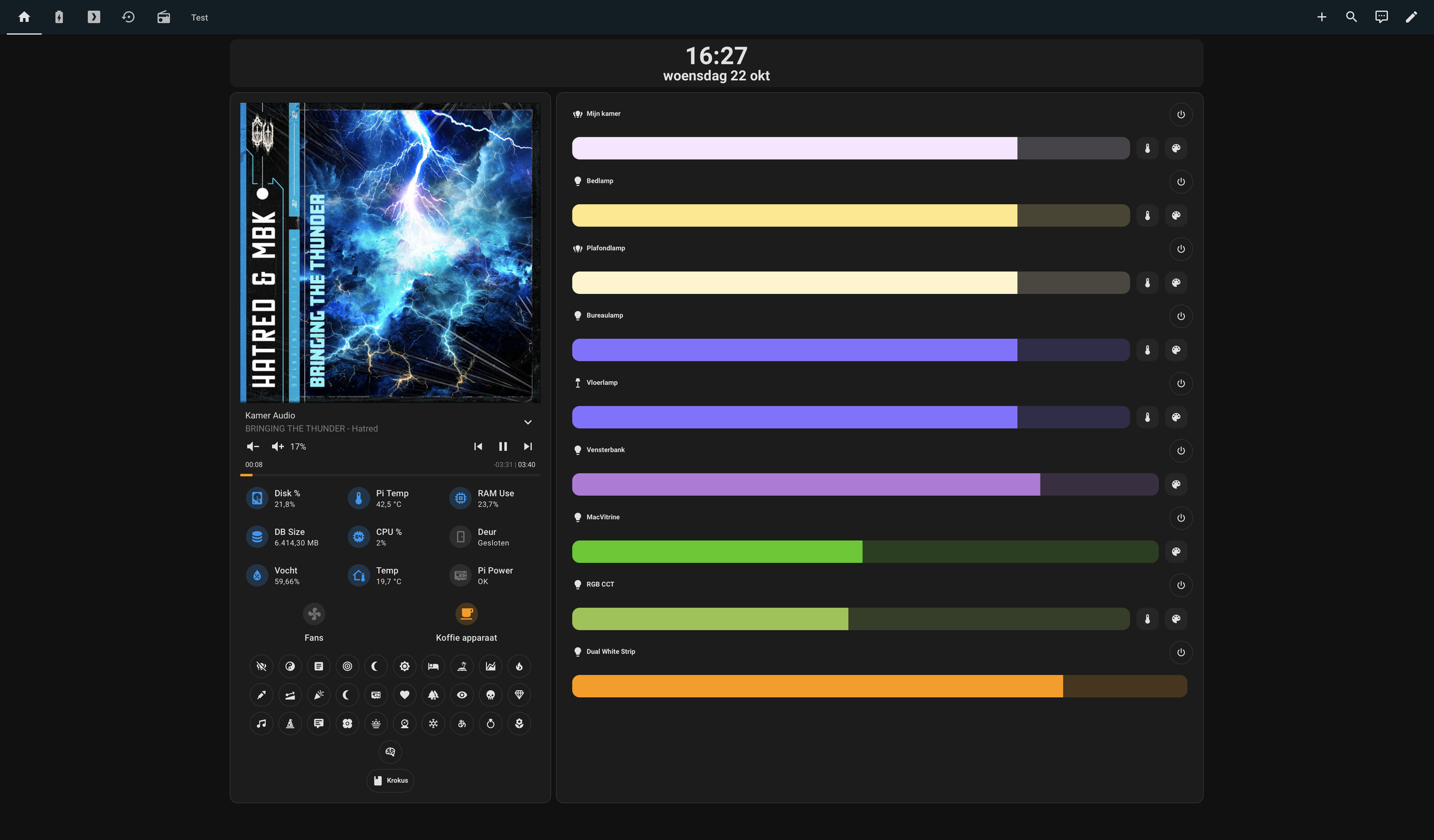

With use of the home assistant YAML code in ESPHome, you can program the ESP32 and toggle the transistor with the home assistant entity.
