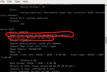

  3. Next, open a terminal and run this command:
pactl list sources
  1. Look for something like bluez_output.<MAC-ADDRESS>.<profile>.monitor
  2. Ensure it is your device by looking for this under the name: Description: Monitor of <DEVICE NAME>
  3. Once you have found your device, copy or make note of the name (bluez_output.<MAC-ADDRESS>.<profile>.monitor). You will need this for later. (See image 2 for an example)
  4. What you just found was the monitor for this Bluetooth device. It controls the audio being output or input from that device. We can capture this audio and stream it to our station.
  5. Now we need to set the monitor as the default source. Run this command:
pactl set-default-source <source-name>
  1. Replace <source-name> with the name you copied in the previous step (bluez_output.<MAC-ADDRESS>.<profile>.monitor)
  2. Use this command to confirm the change:
pactl info

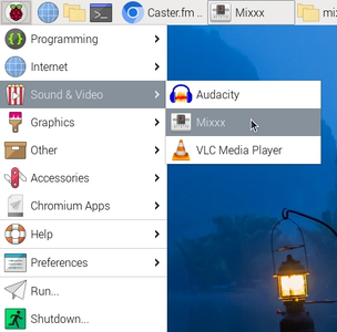

  1. Now we can start working with Mixxx.
  2. Open it by navigating to the Start Menu > Sound & Video > Mixxx (See image 1)
  3. After opening Mixxx, navigate to Options > Preferences (See image 2)
