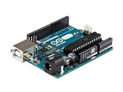

  • Arduino UNO (or any other board)

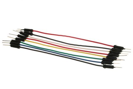

  • Jumper wires

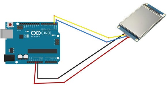

Step 2: The Circuit
  • Connect Nextion Display VCC red wire to Arduino 5V pin
  • Connect Nextion Display GND black wire to Arduino GND pin
  • Connect Nextion Display Yellow wire (RX) wire to Arduino TX pin
  • Connect Nextion Display Blue wire (TX) wire to Arduino RX pin

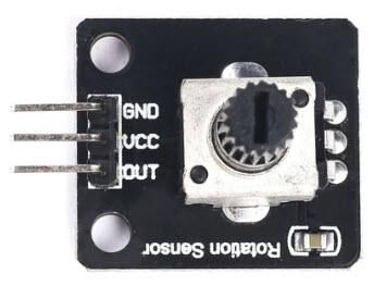

  • Connect Potentiometer pin[VCC] to Arduino pin[5V]
  • Connect Potentiometer pin[GND] to Arduino pin[GND]
  • Connect Potentiometer pin[Out] to Arduino Analog pin[A0]

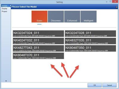

  • In the "Setting" window select the Model of your Nextion Display & click "Ok"
  • Select Display Direction 90 & click "Ok"

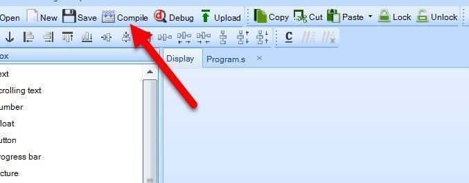

  • In the Toolbar click on the "Compile" button

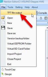

  • In the Menu Select "File" > "TFT File Output"
  • Set the Output folder & click on the "Output" button

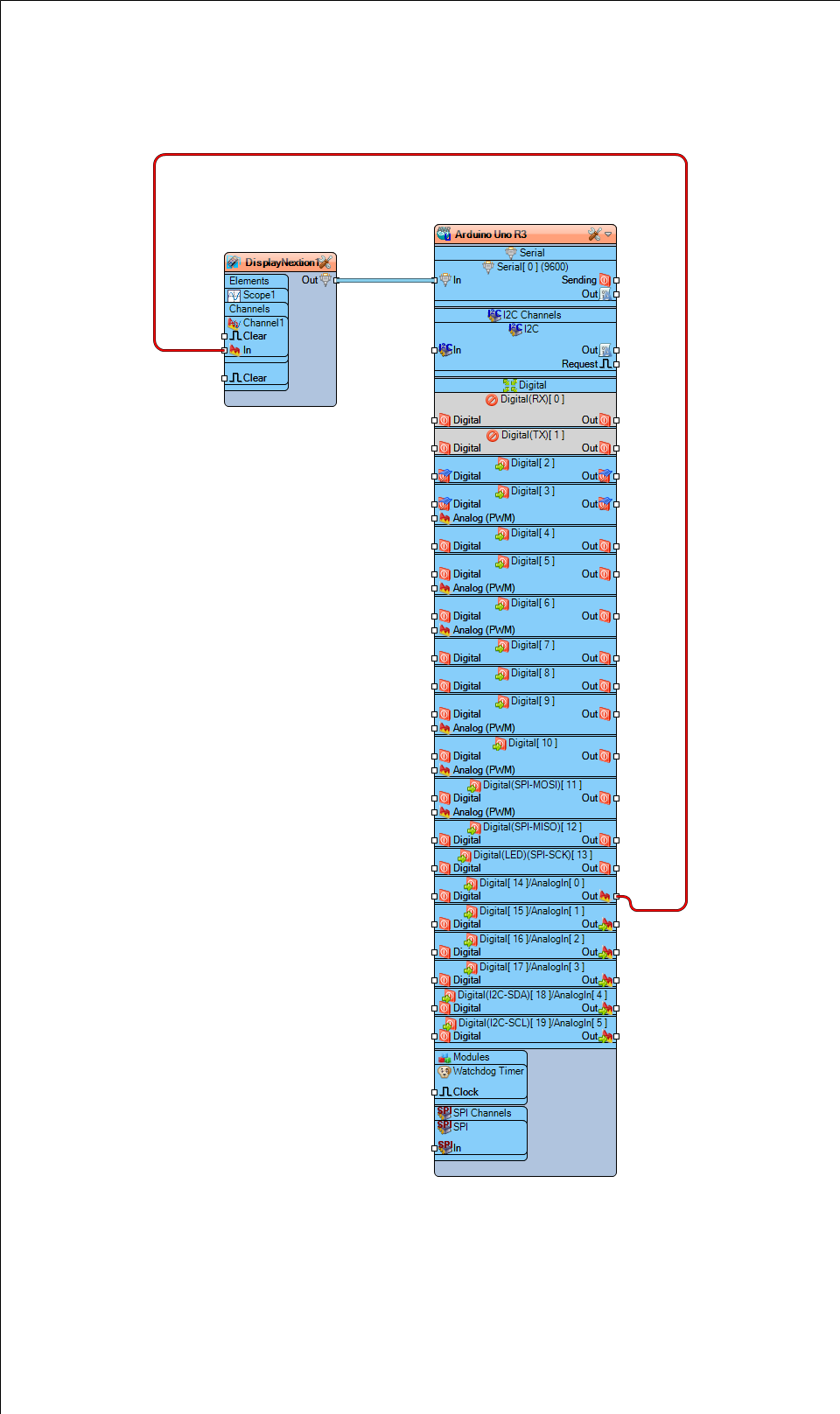

Step 4: Start Visuino, and Select the Arduino UNO Board Type
Start Visuino as shown in the first picture Click on the "Tools" button on the Arduino component (Picture 1) in Visuino When the dialog appears, select "Arduino UNO" as shown on Picture 2
Step 5: In Visuino Add & Set Components

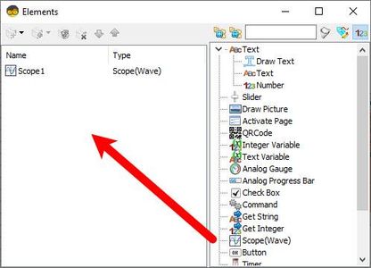

  • Add "Nextion Display" component
  • Double click on the "DisplayNextion1" And in the Elements window drag "Scope" to the left side
  • Close the Elements window

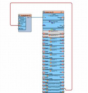

Using Signal generator:

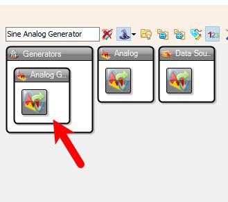

  • Add "Sine Analog Generator" component
  • Optional Set "Frequency" or other properties in the Inspector window
  • Connect "SineAnalogGenerator1" pin [Out] to "DisplayNextion1" > "Scope1" > "Channel1" pin [In]
Using Potentiometer:
  • Connect Arduino Analog pin 0 [Out] to "DisplayNextion1" > "Scope1" > "Channel1" pin [In]

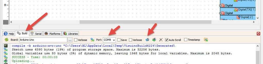

Step 6: Generate, Compile, and Upload the Arduino Code
Before Uploading Disconnect RX pin on Arduino and connect it back after the Upload.
In Visuino, at the bottom click on the "Build" Tab, make sure the correct port is selected, then click on the "Compile/Build and Upload" button.
