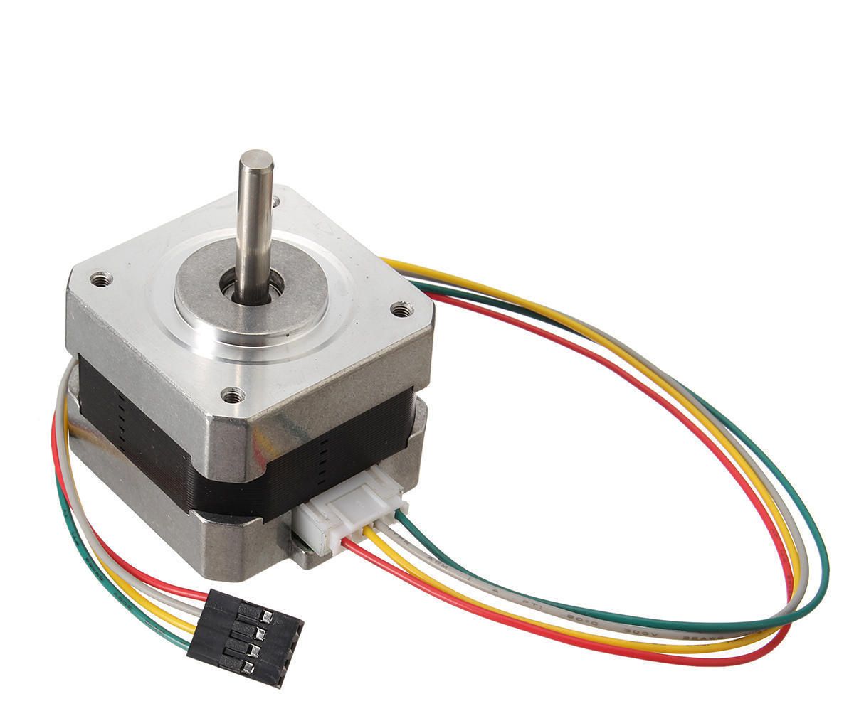

As i said above, we need only 4 components to make this device, so here they are:
1) An Arduino (i used nano) - this will be a brain of all system;
2) A servo motor - it is a locking element, you can use any other stuff you like for this purpose, tihs is all on your fantasy;
3) 10k rotating potentiometer;
4) A small button - i used a button from old broken mouse;
and.....that's all! Yes, lets start building!
