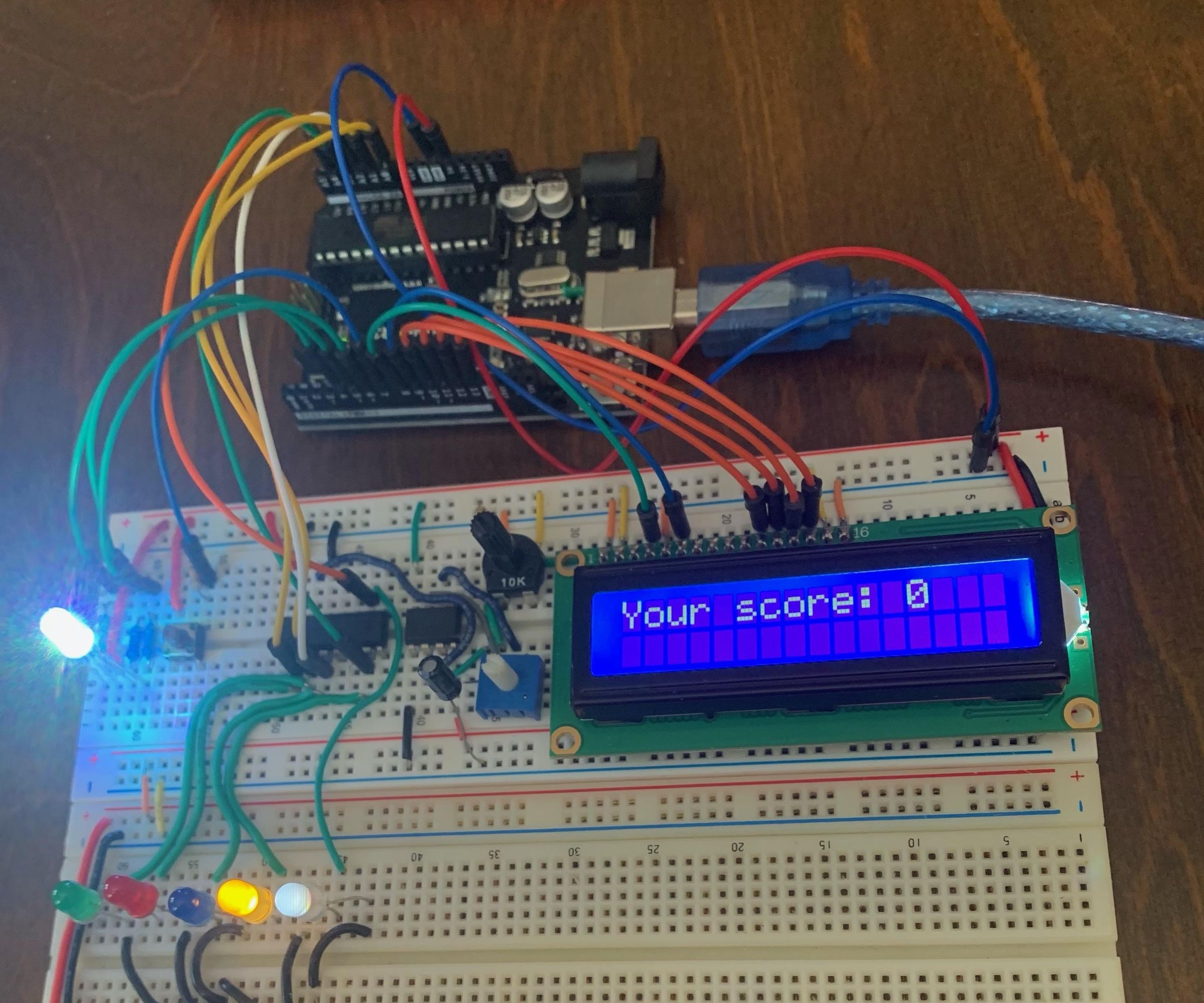

For the next step attach three potentiomiters next to eachother as well as red and black wires coming from their left and right pins in order to provide the components with power and ground. These potentiomiters allow us to control the 3 joints of the arm with 90 degrees of motion.
Step 5:
Next, attach two push buttons and 5 led's as shown. These will be used as a method by which to program functions into the arm by just using hardware, no software.
Step 6:
Attach the 7 resistors to the breadboard as shown. Two 10k ohm resistors are connected to the right most leg of each push button and into ground, and five 330 ohm resistors are connected to the right most leg of the red LED's and into ground.
Step 7:
After you have attached the resistors it is time to connect up the potentiometers and the buttons. Follow the diagram as shown and attach a blue wire from each of the middle pins of the potentiometers to slots a0, a1, and a2 on the Arduino. Then proceed to connect power to each of the buttons as shown by the diagram and their signal pins in 12 and 13 just above the resistor as shown.
Step 8:
After you have completed step 7 you can begin to attach the signal wires for the red LED's. Attach five yellow signal wires from each left leg of an LED to pins 8,7,4,3 and 2 respectively. Once you are done, proceed to the next step.
Step 9:
Next, place your 3 servo motors with the connectors facing the breadboard. After doing that, make three sets of connections for power and ground that the servos will use when they are connected to the breadboard. Follow the diagram as shown in order to connect the wires correctly.
Step 10:
For this step we are attatching the servo motors to the breadboard. Start by connecting the power and ground of each servo to the power and ground connections we made earlier. Then, following the diagram, connect the signal pin of each servo to the left of each power wire so that it may be connected next.
Step 11:
Once you have completed step 10 you can begin to connect the signal wires for the servo motors. Using pins 9, 6 and 5 connect 3 signal wires to the three servos as shown. This will allow the servos to receive an input from the potentiometers through the Arduino.
