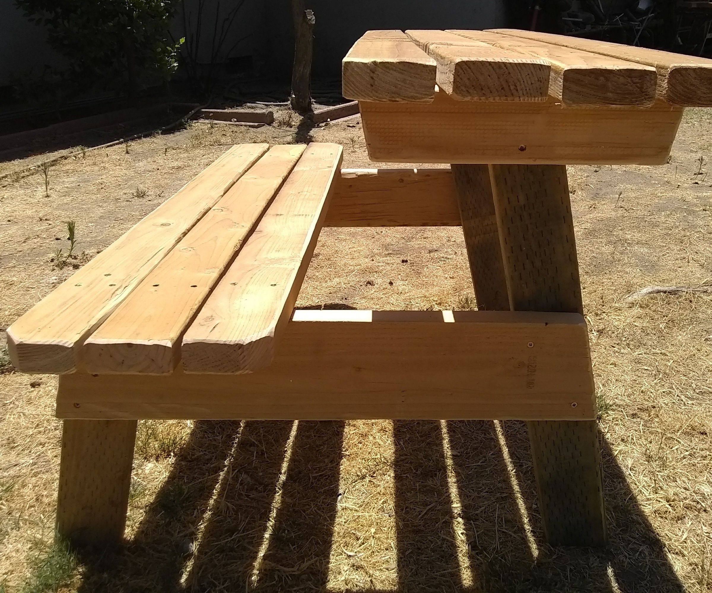

Here's a simple yet sturdy little bench. A friend asked if I would 'up-cycle' some old leftover redwood fence boards (the vertical 'pickets', not the grass board). He conducts a little seminar/workshop each week beneath his redwood trees, and wishes to provide some of that new-fangled 'social distancing' for his visitors. Built for only ONE person at a time (only 30 inches long), they now serve him and his group quite well.
His boards were five-foot long and eight inches wide - you'll see that clearly in the cut-sheet below. This project is easy to modify if you'd like a 45 inch bench, or if your boards are 10 inches wide.

My friend then asked that I make a two-seater. The stretchers would have to come from a partial third board. Certainly, the seat could be a bit shorter and the legs taller, BUT the extra height would make the bench less stable and more likely to tip, so 45-in became the seat length.
