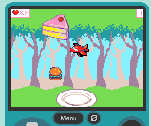

This is a little and simple shooting game in the arcade makecode program (arcade.makecode.com). You can download and play it for yourself (using this link). WARNING: I have no talent for creating pixel art sprites so the project is VERY UGLY, feel free to change the textures.
The Arcade make code is an online program with a built-in emulator, so you don't need any special hardware to use it, but you can play your games on physical devices (you can see some of them in the image included. You can also use a raspberry pi 0.) more on arcade.makecode.com/hardware
